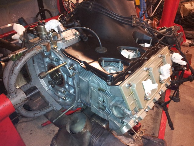

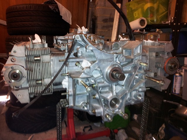

Here is a pic. Still a few bits to fit before finally finished.

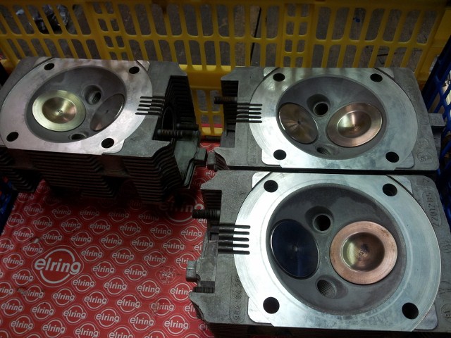

recondition heads including new exhaust valve guides and 3 angle valve job, vapour blast
check & clean barrels and Pistons
repaint all tin ware
vapour blast fan and cowl
new rings
all handled by Nick Fulljames at Redtek came to ÂŁ1500 approx

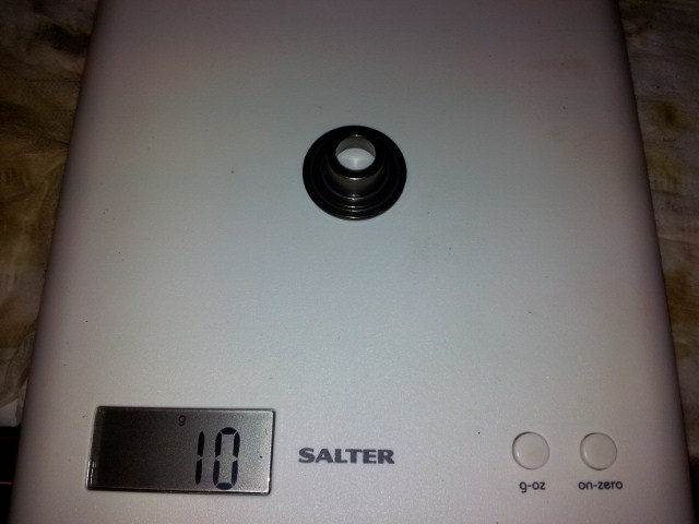

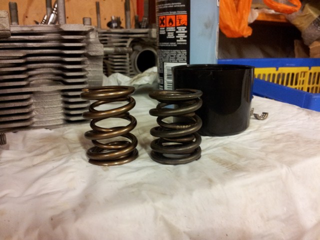

titainium valve spring retainers and sport spring set complete
ARP rod bolt set all from either Porsche or EBS racing ÂŁ1400 approx

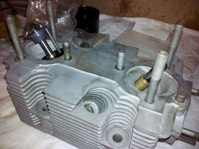

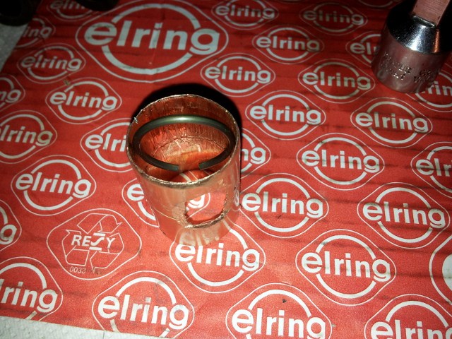

C clip tool . My god those things are a pain. I ended up making this, which i suppose is similar to the factory tool. It's a 20mm plumbing coupler with a hole cut out out and filed. It works a treat. You can see what a tight fit the C clip is. For the less technically minded the C clips hold the Gudgeon PIn (wrist pin) in position on each piston.

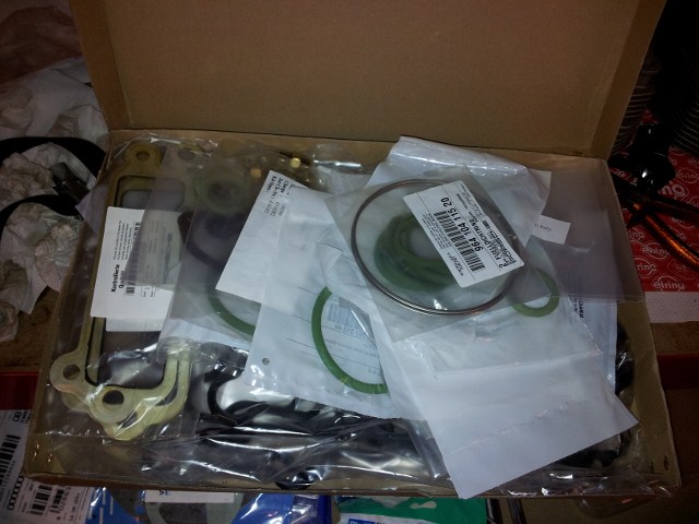

Thought this is worth seeing. A full Top end gasket set from Porsche. You end up with a virtually empty box when finished. Only a few gaskets get left in the box, namely ones that aren't part of RS spec Power steering pump seal etc for LHD RS.

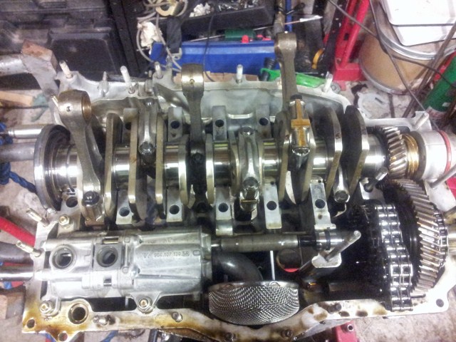

Most things came out within tolerance with exception to the exhaust valve guides. bearings were replaced as a whilst i'm there thing. The engine in general was in pretty good sshape as a 55k miler should be. It only came apart to cure leaks that were part of old age. The decision to strip the engine completely was really because once down to the rods poking out of the case there isn't much more to come apart so i went ahead and did it. I did not want a nice fresh top end only to find something go leaky on the bottom end a few months later. There is however a lot more work involved when putting it all back. Plus i would not have wanted to try and put the arp bolts in without splitting the case.
Picture shows rod bolt being fastened using the ARP recommended way of measuring stretch.

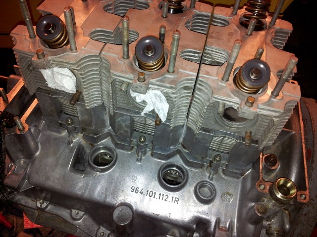

pic shows engine coming together
