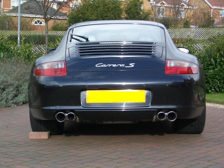

Here is a shot which shows rear with O/S spacer in and N/S spacer out, the visual difference is only very subtle!

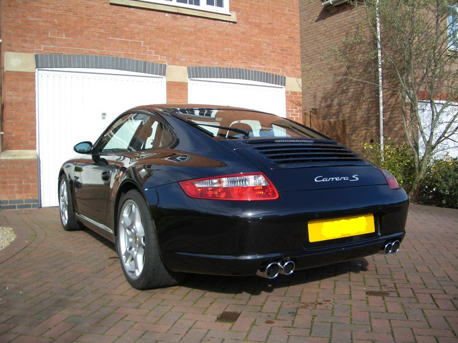

Rear view. I think the changes are only subtle - not exactly "Carlos Fandango" wheel extensions (If you can remember that old advert?)
