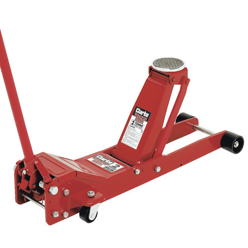

Got me one of those fancy alloy Clarkes low height trolley jacks, available from Machinemart pops straight under, i use the central jackpoint as indicated by the sill marker.

Frenchy - this one? http://www.machinemart.co.uk/shop/product/details/clarke-2-ton-low-profile-trolley-jack-ctj2lp
http://www.machinemart.co.uk/shop/product/details/ctj1250a-11-4-tonne-aluminium-trolley-jack
one of these I believe.
Thats the kiddie DaveL, mine was circa £70 via e bay..........works a treat my 20 year old trolley jack was showing signs of weeping around the seals...........time to get shot, i feel quite attatched to my fingers and legs !
