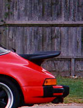

I've seen three different wings fitted to this year car. The favourite option for me would be the Turbo tail as it is the most stylish IMHO. It was an option , the standard one is similar to the later Carrera 3.2. I have also seen the earlier all rubber wing fitted, though I don't think this is standard for this country. I'll try and post some pics.
Rubber wing
Looks to me like the optional turbo wing looks good as you say , so i guess i'll start looking for one , i guess get some membership sorted and then place a wanted advert .....

I guess its personal taste but i prefer the car with the tail. I decided to go for the 930 turbo tail, as i think it just looks the best.
The all rubber tail was the standard Sport Equipment tail until some time in 1981 when the 3.2 Carrera style tail was introduced as on Peter Bull's mint original late SC Sport.All the books are pretty vague on exactly when.The turbo tail became an option at about the same time as so many people were asking for it.My car is an 80 model and when I saw a picture of the 1980 Weissach Edition SC released in the US with a fibreglass lid with whaletail as on the 74-75 2.7 Carrera I decided it was just about original and fitted one of these on my car as I never liked the look of the 3.3 turbo tail on the narrow body.Just a matter of taste I suppose.
