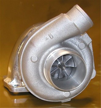

I have uploaded a picture from Lindsey Racing of the Sports Turbo hopfully the uploads has worked ! As you can see from the pic it's a nice looking bit of kit with the bullit type intake less drag , still have my option open as to which approach to take . As you have said with the bigger Turbo's seem to give more Lag as well , and there for not to easy to drive the car every day so to speak . Thank you all for your imput it is gladly appreciated , best regards J

You have plenty of options regarding aftermarket turbochargers for our cars, but you need to decide if you want quick spooling, huge top end power, lots of midrange torque etc. There is always a bit of a tradeoff between all the different sizes and specifications and there is no 'one size fits all'.
As well as the Lindsey options already mentioned and JMGarage (which is who I used for the hybrid ball bearing turbo in my car) you also have good offerings from http://www.vitesseracing.com/ , www.speedforceracing.com and also www.promaxmotorsport.co.uk who provide all the Lindsey kit over here in the UK
Once installed, you seriously need to look at your fueling as the standard map and the antiquated AMD chipset will be way out for a bigger turbocharger and you run the risk of running dangerously lean and detonating your engine [:eek:]
Lindsay turbo's, from what I gather, will certainly do the job and there are plenty of people out there using them and who are pleased with them. However they are not pushing the limits of turbo technology. The contact that Ed put you onto builds his own turbos utilising the very latest technologies. The problem with turbo's is that they have a relatively narrow efficiency band i.e probably 3k - 3.5k rpm so you either size your turbo such that the efficiency band is low down in your rev range (good for street use - minimal lag), at the top end of the range (good for high HP numbers and track work as engine revs are generally kept high, but with lots of lag), or somewhere in the middle to get some compromise between the two.
A good example of this is my car. I've increased boost on my 220bhp turbo with the stock turbo and i'm currently getting 275bhp. The boost comes on strong low down in the rev range but there is a definate reduction in urgency as the revs rise as the turbo gets out of its efficiency range and can't flow enough air to maintain pressure.
However Jon Mitchell (though I think the turbo's are build by Simon) utilises the latest technology therefore giving you a wider efficency range. The Lindsay turbos are good out-of-the-box / off-the-shelf turbo, but Jon can get you built a turbo specifically for your needs. It's more costly, but you get what you pay for.
Another source for an off-the-shelf turbo is Vittesse Racing: http://www.vitesseracing.com/ who offeres something called a 'quick spool' turbo.
I think at the end of the day as Ed has said, don't be fooled by impressive HP numbers. A big turbo pushing alot of air will always give you good HP figures (look at Mitsubishi Evo's), but not necessarily in a usefull part of the rev range, meaning you have to thrash your car to utilise it. That's why talking to someone like Jon about what you want means you will get the right turbo first time which is cheaper than doing the job twice.
