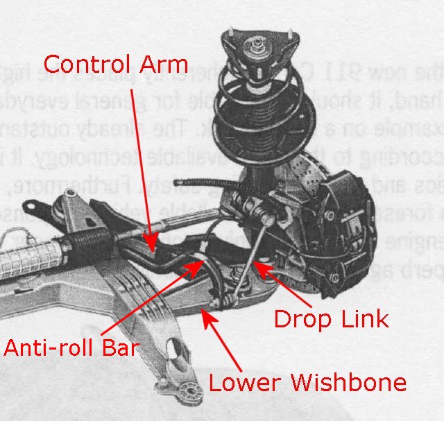

So that I don't completely empty my saving account. I will replace the drop links first. But I did see an article on Piston heads where someone mentioned that the clicking was caused by worn forked arms and note the Coffin Lids? Or am I barking up the wrong tree. The article had a brill picture of the front suspension assembly, unlike my 996 maintenance manual CD.
As Eddie Izzard says in the recycling adverts, "The possibilities are endless".
This picture?
