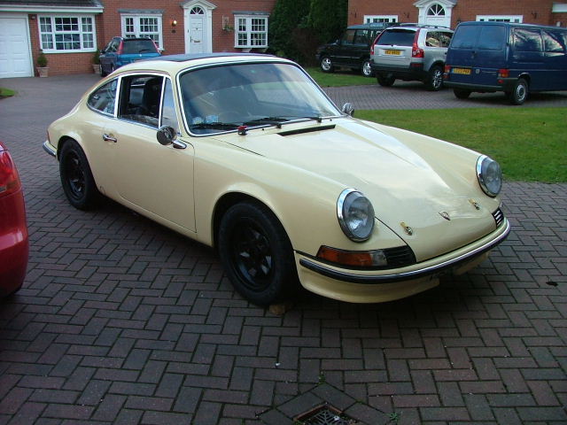

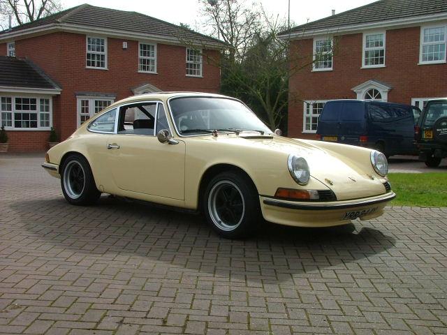

In the class I run you have to have a 6 point cage minimum, but having hit a big tree at the top of Shelsley Walsh some years ago, no race car should be without a cage...in my opinion.
The chassis has 3 litre Turbo rear torsion bars and 2.7 Caraera roll bar, stock front torsion bars and 10mm (I think) through body front anti roll bar. Turbo rack.
Bilstein dampers from Bob Watson a zillion years ago.
Rear arms are 3.2 alloy and the rear has poly bushes everywhere. The front did have spherical top mounts and poly bushes but were sold to Ian McMath and another and replaced with stock rubber bushed arms.
The ride height is set to get the jack under the front cross member!

I took the car for a first drive in ages on the fresh Kumho's and brakes and it all came flooding back and why I kept this fab Bitza over the years. Could have sold it several times over.
Bought it in 1988, so 20 years as a family member [:)]
Is that 'sad'?
No, I'm very very lucky.
