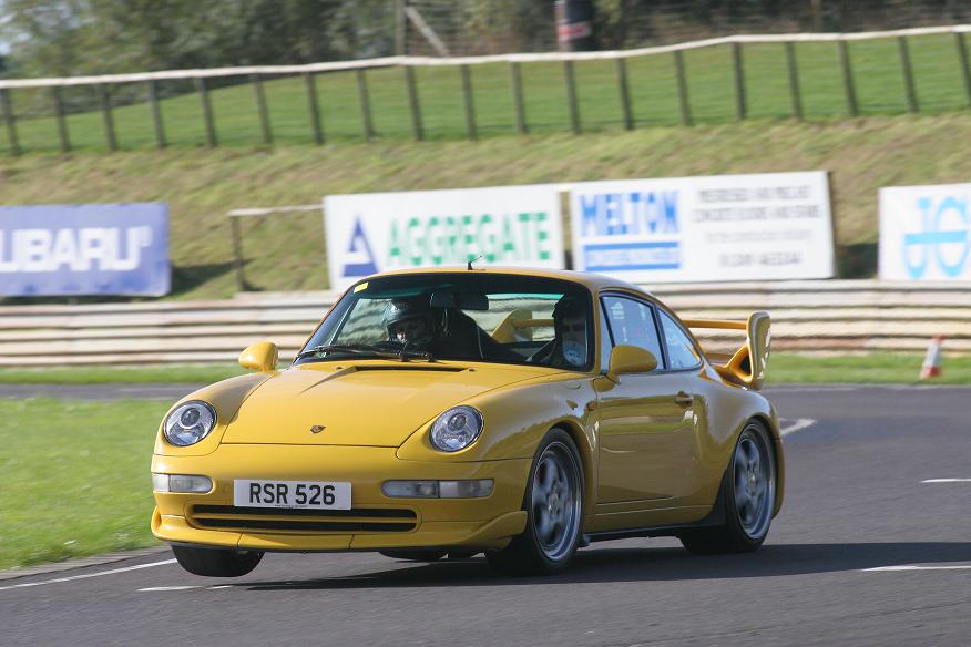

Interested in Leesweeney's post re car for the track. I already have (for me) the ideal car for the track, my 993 c2 with modded suspension, brakes, billet heads etc.
However, i also use the car for the road so don't want it to be completely uncomfortable / unusable for the occassional blast into the Office or the trip to tracks which are a long way away.
So the next step has to be lightweighting. I already have LWF, no aircon - didn't come with aircon, lightweight exhaust - full cargraphic system, lightweight Recaro SPG seats, 996 five spoke lightweight 18" wheels, what else would anyone suggest, don't really want tp spend £1,000's more on the car, as it has already cost me more than an RS, and no I am not about to trade to an RS !

Oliver, good point, however changing the seats made a really noticable difference on the track as does adding a passenger (going the wrong way in terms of weight) so i figure more weight out will make a big difference.
She weighted 1290 (without me in the drivers seat) when we weighed her for the Total 911 article the other day (billet head article) and that is with rear seats, full leather interior, sound package (ten speaker system), full size battery, etc etc.
So she is not massively heavy at the moment.
By contrast Colin's stripped out race 993RSR weighed 1190 and he has replaced many body panels with lightweight parts etc.

Just for reference my RS weighed in at 1260kgs, including 1/2tank of fuel, small extinguisher,and 1/2 Matter roll Cage.

No cage (and no plans to put one in) and I didn't have much fuel in when weighted about 15 - 20% full on the guage.
