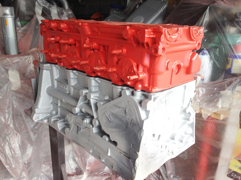

Sneak peak at the new paint job in progress, pre lacquer:

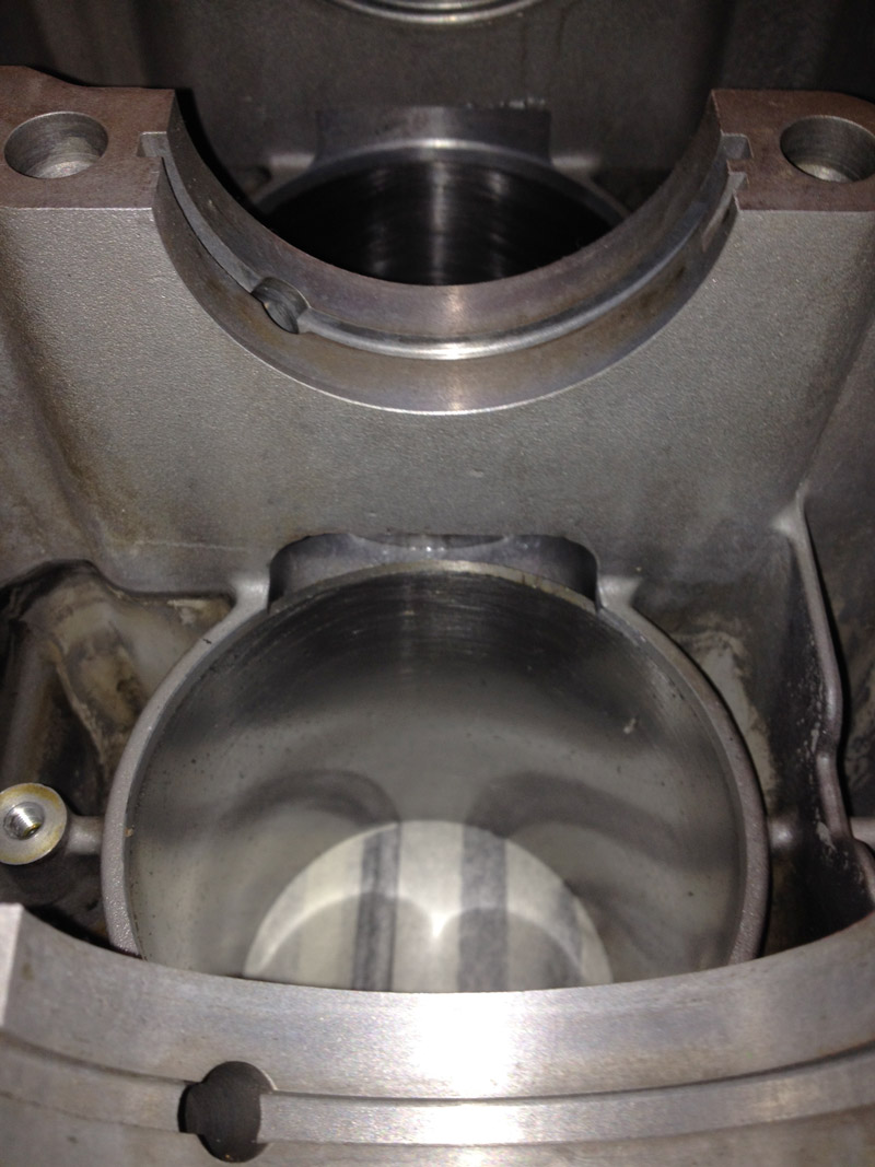

Can you post some pics of the blocks showing liners installed? How much was it for all the work on the block, if you don't mind me asking?
To have the liners installed was £1200.
Block is all masked up at the moment whilst the lacquer cures and then it's straight off to the engine builder for a couple of mods, but I'll take some more pics as the build progresses.
The sleeves look the same as most other sleeved S2 blocks to be honest, there's some pics on the EMC website that look very similar.
