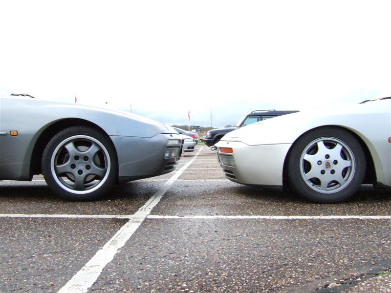

Not the best pic, but here's my mine - lowered to the max on the rear without re-indexing running KW V.3's
That looks really nice mate, no arch gap which is what im looking for [:D] Think the best way is going to be coilovers up front then just have a play with the back and see where I like it, may not need to re index the torsion bars if I get the wheel and tyre set up spot on, seen a guy running staggered borbet A's in a 17" that looked real good, think they were 8s and 10s, not sure on offset tho
