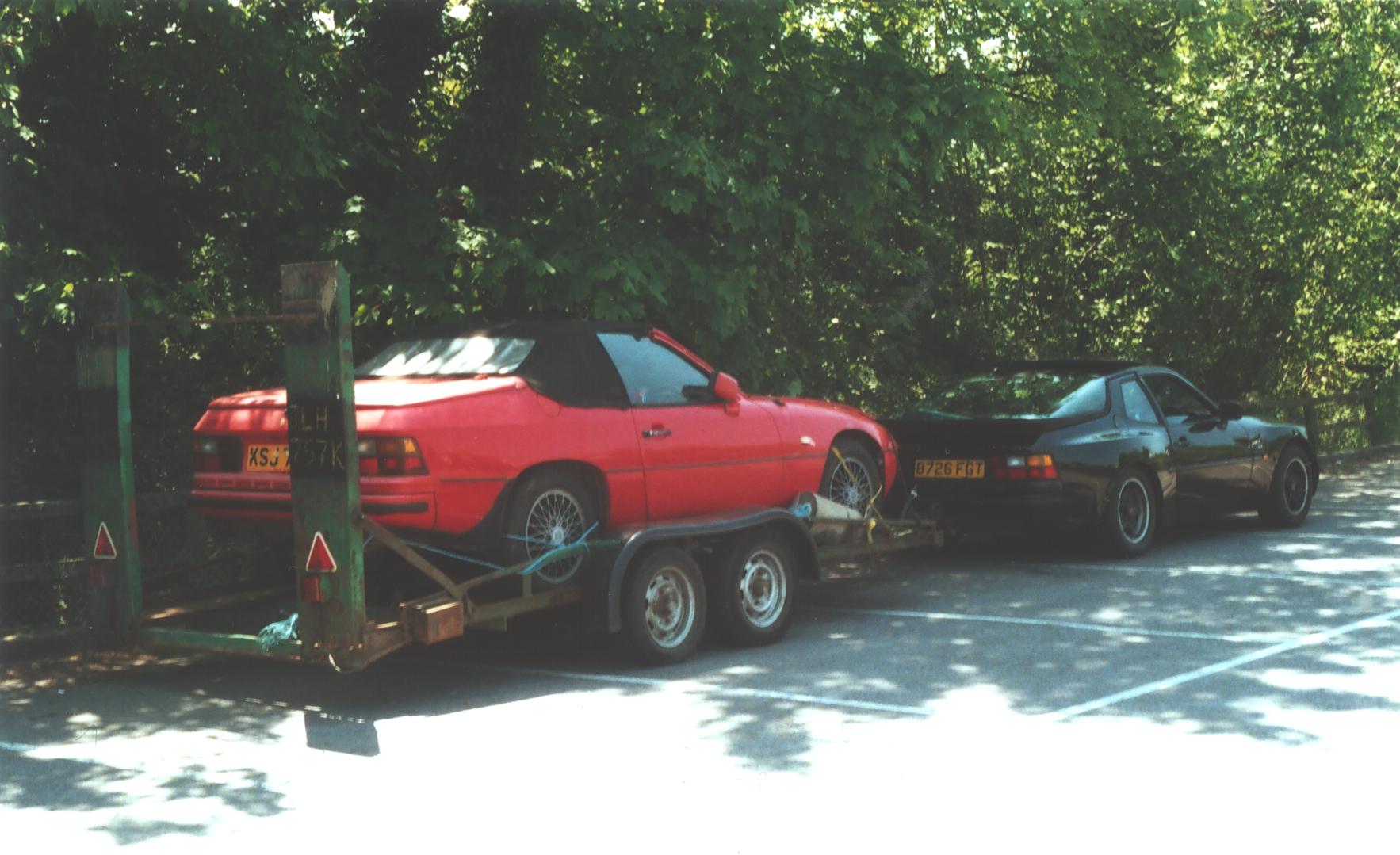

£70 per week in petrol, and I never use the back seats (which is where the lpg tank is going).
It now has a towbar on it too, and oh yes I use it[:)]
Tref.
ORIGINAL: tref
Does this make it easier to stomach?
Mind you, I have roof bars too.
It gets worse, the black NA is now a black S2, and his ABS works!
(unlike mine, but thanks Tref for verifying that my ABS main relay is fine)
Hmmm, and the red one looks like a soft-top 924 - non?
Hand-done aftermarket conversion? As has been discussed on here before?
Oli.
I am sure Tref will talk about it soon, but its a 924 turbo convertible one of perhaps 6 in the world ISTR built as aftermarket conversions. The amount of work Tref has put in to this car is amazing, I hope it gets finished soon because its more then an a year and a half now since I remember fitting my brake ducts at Tref's house whilst he tried to finish of the engine install (or was it removal).
The 924 Cab project has been over a year in the bodyshop, and it has been teh subject of many articles in the 924 section of Porsche Post... It will probably be the subject of many more once it comes out of the bodyshop too!
