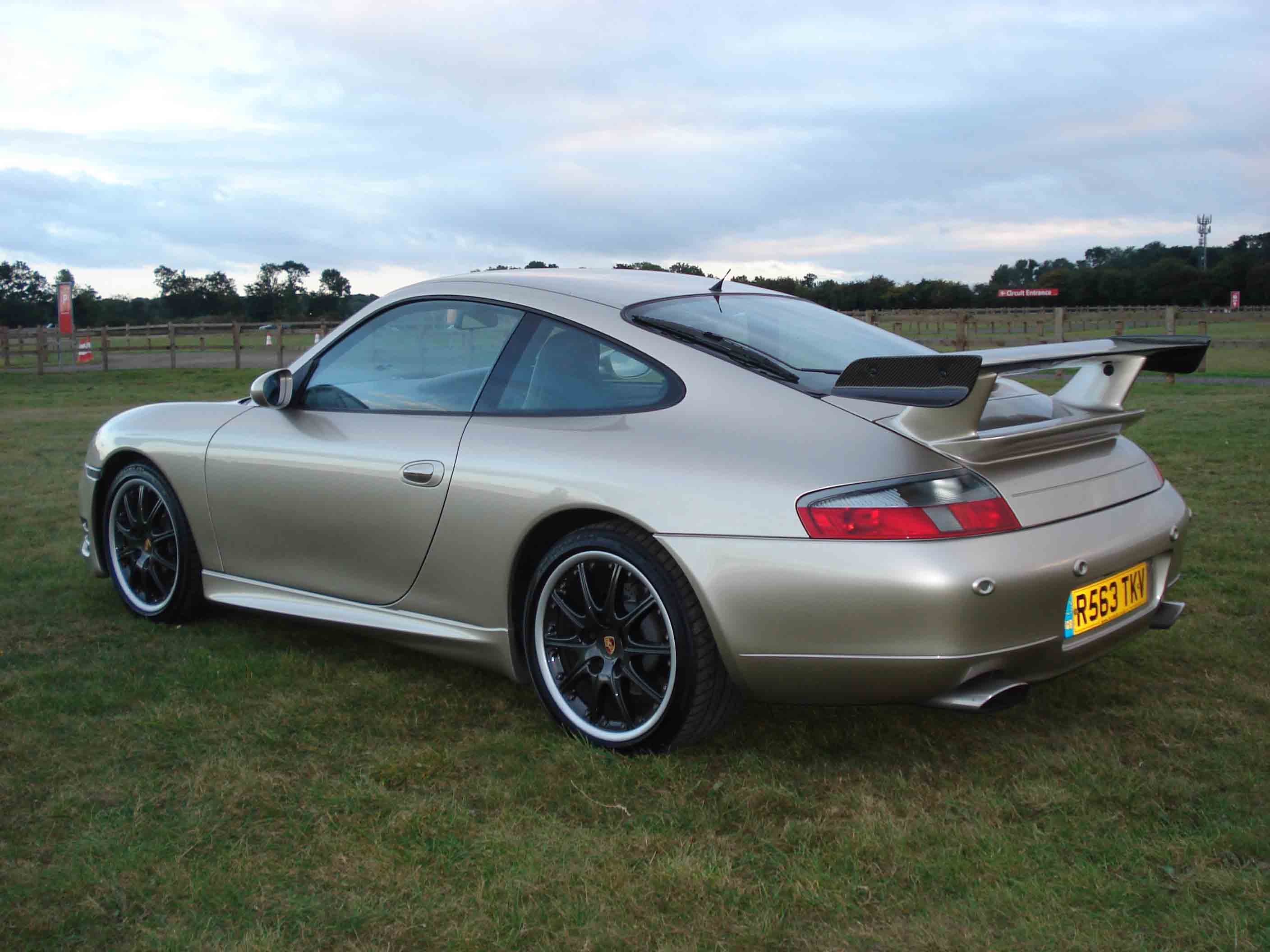

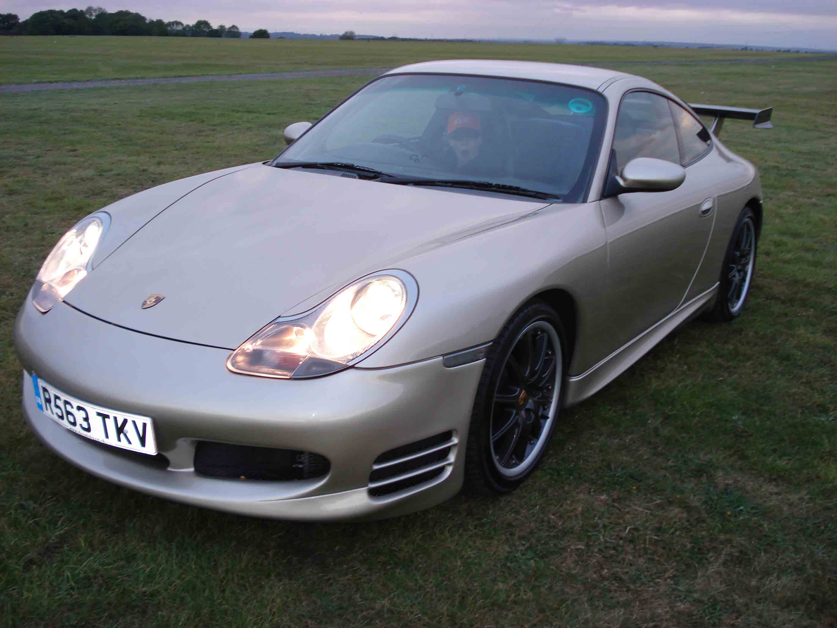

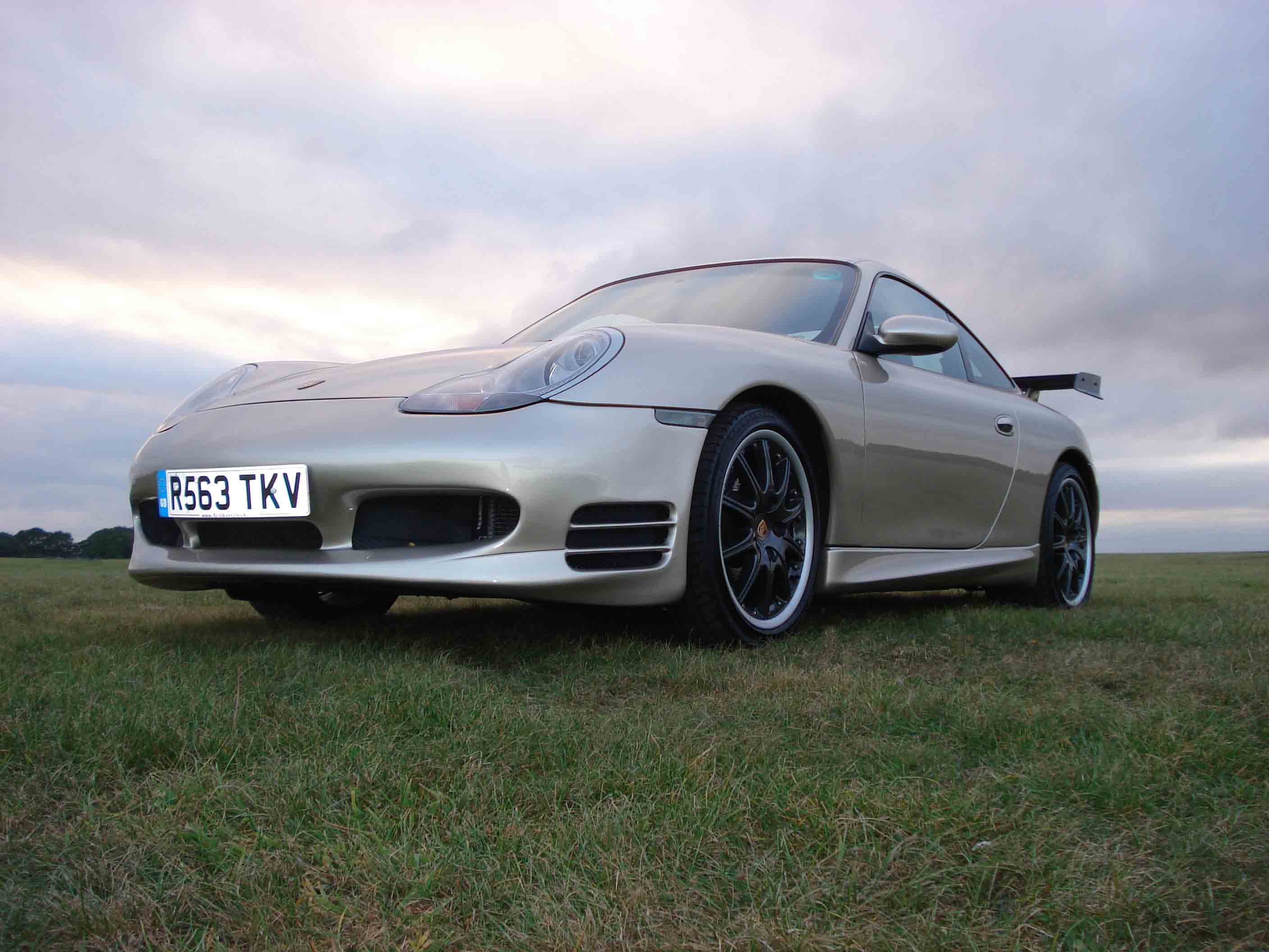

Hi all,
Thanks for all your replies, ideas and thoughts.
Here are some photo's of the finished version. Sorry its taken so long, I have had more than my fair share of teething problems getting it sorted.
Design 911 supplied and fitted all the parts and (outsourced) the painting and repainting and the re-furbing of the wheels.
Overall, I am pretty hapy with the finish (eventually) and looks.
Its a GTR front PU, GT3 side sills and a GT3 RS rear spoiler. They also connolised the interior and refurbished and painted the GT3 SD wheels.
Just have to decide on what colour under car lighting system and furry dice I need now!
