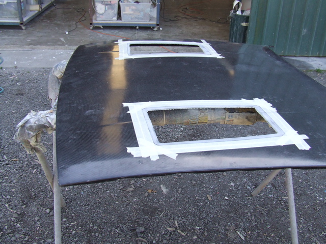

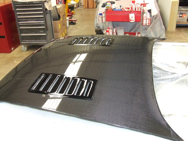

Oh, I have finally had my c/f bonnet finished after being stuffed around by one guy and then the next guy took his time, but this is the result. Put some D9 hood vents in while he was at it. Looks a bit ricer but it will be going on a black car so I think it will be ok. Can always paint it.
The Backstory is that I bought this hood from Van Zweden (in Holland) at the same time as I met some of you guys when I was in the UK. When it arrived it was less than I expected in terms of finish so that's why I've had it sent away to be 'completed'. It has become a very expensive, long winded, and frustrating exercise. Shipping was not cheap either.
Ah well, live and learn...[:mad:]
Here's a bit of a before shot.
