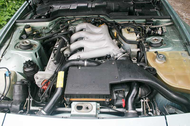

[edit: I have changed the picture to one of my engine bay:]

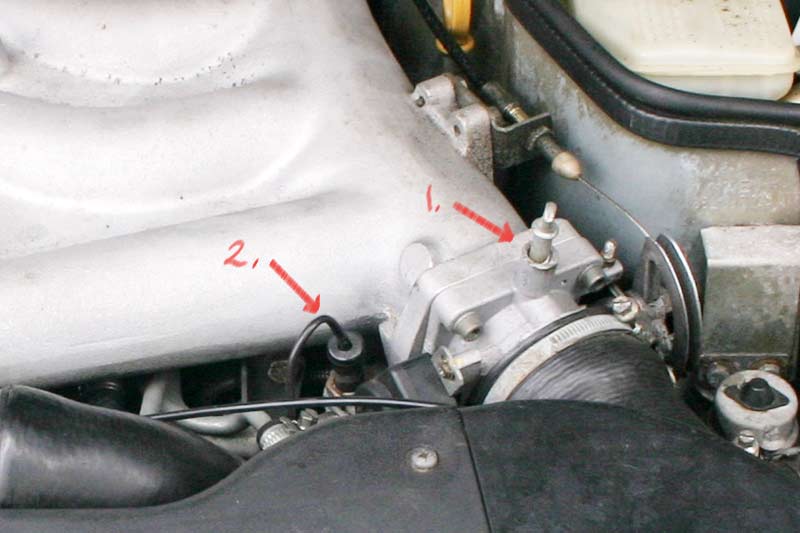

Actually i've spotted something a bit strange from your photo. I'm pretty sure that your vacuum line from your recirc valve shouldn't connect directly to your fuel damper at the end of your fuel rail. I'm pretty sure it should connect via a T-junction that connects between the recirc valve, the fuel rail damper and a line that runs under the inlet manifold headers to another T-junction that connects to the manifold itself and yet another T junction that connects to the Fuel Pressure Regulator at the other end of the fuel rail and then over the other corner of the engine bay to the vapour purge system. Crickey, I hope you're following this!!!! I'll have to check on my car to confirm.

The bit arrowed should have a screw in it with a seal, IIRC its for setting the idle speed once the idle stabaliser is bypassed. it will leak boost and make you run rich - black smoke.
Any leaks in the intake plumbing after the airflow meter (beside the air filter) will make the car run rich. the air flow meter measures the amount of incoming air from which the ecu decides how much fuel to inject - if some air escapes after it has been measured you will get too much fuel. Boost leaks will also lose you power so stop the sir escaping and you should go quicker. The dump valve is another common leak point as are all the small vacuum/boost lines.
Tony
Arum,
If that arrow is pointing at the cast upstand on the throttle body, it should have a brass screw in it.
Its not his engine in the pic, but it is unusual the banjo bolt for the wastegate signal (via cycling valve in a standard car) is different as well,

4. That hole IS where the idle screw should go, again it costs pennies and it will be contributing to the rich running.

PLEASE NOTE I CHANGED THE PICURE OF THE ENGINE BAY, IT NOW SHOWS MY ENGINE!
the subject of the original question is shown by arrow 1. Arrow 2. shows what I believe to be a temp sensor, it is very loose and I suspect it is faulty as the turbo fan does not come on when the engine is switched off...
also, here is a full picture of my engine bay. More pics to follow of the rest of the car after a nice wash.

Cant see arrows, if it is running excessively rich I would also be suspicious of the wiring inside the red tape on the connector to the the air flow meter.
Is there just one screw misisng/broken on the airfilter box or has one at the rear gone too?
