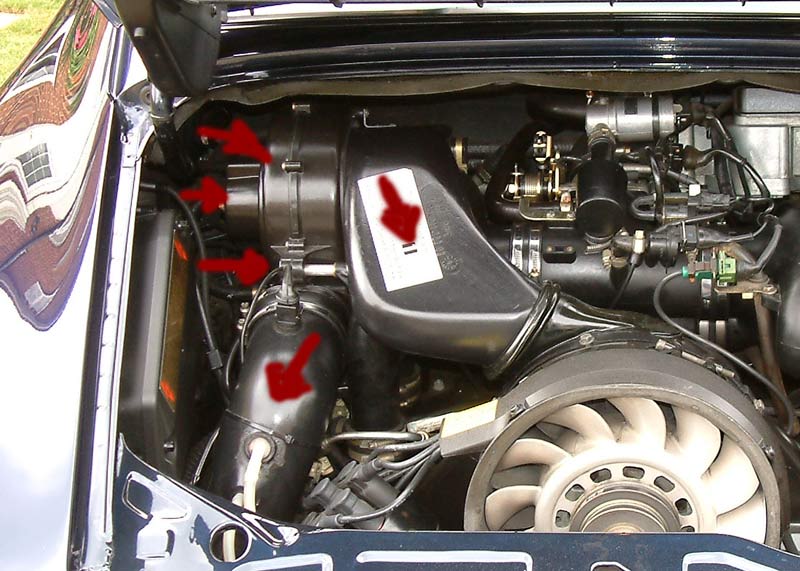

The 'blower motor' at the LHS in the rear, it is a common problem, either packing up ar noisy, maybe just needs aligning as mine did, it was offcentre and blades hitting the side.
You can easily get to the fan and dismantle it so far, there are 3 bolts (arrowed) to remove the blower and the 2 large bits of air trunking (arrowed) held on by big jubilee clips and a plug on the lower trunking.
Just remember when you remove the lower trunking from the heat exchanger fill the large hole with a rag otherwise you will have to turn the car upside down to get your socket set back [;)]
If you find that the blower is shot, the best option is to buy a motor for the 993, this is a newer design almost identical but needs spaced differently.
Hopefully someone here who has done this may assist with this 964/993query

The noise is identified as the bearings in the heater blower. I have managed to investigate further by removing the cover. This confirmed that it was not an alignment problem which could apparently have been the other problem.
I first identified the noise as being related to the heater blower because it could be stopped by turning the heat dial to minimum and the fan speed to zero and after a short while the fan squeaked to a stop and the noise ceased.
