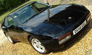

Here is a pic but I cant re-size it on my pc to use it as an avatar[:(]
Nice One Ben, Was this the car we spoke about ? a couple of brand new rear wings were recently on e-bay went for £200 ish each afaik,

Nice car Ben, and another black one for the darkside gang ! [:D]
