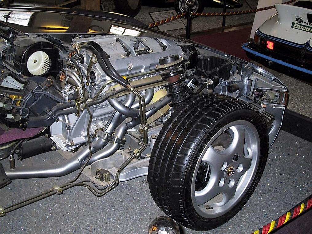

ORIGINAL: Hilux
why is the fitting of of 968 castor bushes highly recommended when running 17 wheels?
Funny you should mention that ... Look at the following picture [:)]
Oooooh that is a good picture that I haven't seen before Thom. I have shamelessly saved it into my useful pics folder as it clearly shows where the caster block is at the back of the A Arm
Oddy enough even though it is a 968 cutaway, it does look like the earlier 'rubberier' mount from a 944 has been fitted [&:] Maybe not all 968s had the later mount?
Maybe the people at Porsche found out that just fitting bigger wheels was not such a good idea after all and introduced the hardened caster block later to make up for their error [:)]
Anyway I certainly saw more than a couple early 968 (1992) with 944 caster mounts.
ORIGINAL: Hilux
The theory is that the 968 bush has lots less rubber so the A Arm is more securely fixed in place. The narrower profile tyre on a 17" wheel is more prone to follow ruts and poor road surfaces when the A Arm can flex in the rubbery 944 mount. The 968 mount reduces this flex so the car drives straighter.

ORIGINAL: Diver944
Ah but it's the lightweight version which dispenses with the mounting bolts. [;)]
