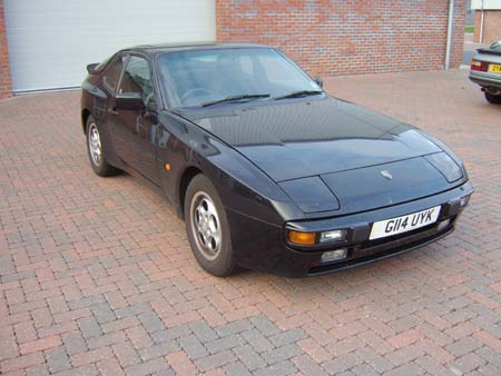

Hi All,
I've been watching this forum for a few weeks now and thought its about time I said hello! I've owned a plain old 924 2.0 N/A for over a year now and loved the handling - but not the engine. I always thought it would be good to try a 944. so, when a rough one came up at a price I could afford I snapped it up. Its a 1990 registered 2.7 Lux (very late registered).
Unfortunately, its in need of quite a bit of TLC; I have compiled a list of following areas of concern;
  • Loads of rust at bottom of O/S wing
  • Small dent in N/S rear wing
  • A million stone chips in front spoiler/bonnet/badge panel
  • Several parking dings (door/bonnet/rear panel front wings...)
  • electric windows not working
  • central locking not working
  • sunroof stuck
  • O/S door check strap broken
  • clutch pedal loose
  • brake lines corroded
  • heated rear screen not working
  • interior trim falling apart (parts missing & damaged)
  • seats well worn and ripped (rears OK though)
  • mystery oil leak
On the bright side;
  • I paid very little for it
  • It does have an MOT!
  • drives and starts well
  • Has had recent cambelt, tensioner & waterpump change
The aim is to blitz these jobs and have a reliable daily driver on the road by New Year [;)]. I know most will think I'm mad for taking on a 944 that really should have been broken for spares, but I'm fairly handy in the garage and whilst things are quiet at work I could plough the jobs.
I'd like to know what modifications and improvements you guys would reccomend along the way whilst I'm fixing it up. Also what should one of these (a 2.7) be worth when its in good condition?

Are those 16" Teledials?

I'd say that those wheels look like 15" Teledials.
16" Teledials - I wish! They're only 15" ones.
