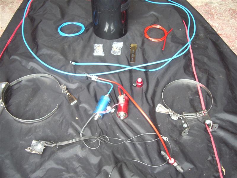

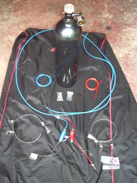

Contains..
1 x 11 lb Nitrous bottle with Power Valve
2 x Bottle mounting brackets (think quick release giant jubilee clips)
1 x long blue nylon pipe (from bottle to engine)

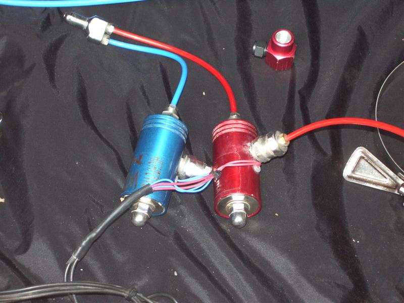

1 x Fuel solonoid (red)
1 x Nitrous solonoid (blue)
1 x micro switch (for under throttle pedal)
1 x fuel T piece (WONT BE USING as its for rubber fuel pipe)
1 x red push button for activation (wont be using as will be fitting a "Fighter Pilot" switch exactly the same as my WOT switch.

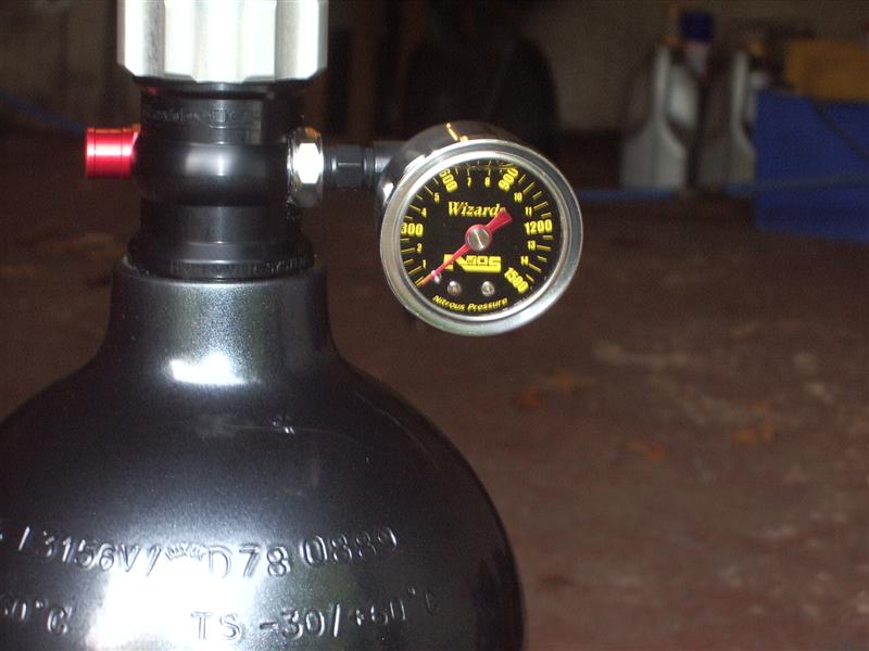

1 x Bottle pressure Gauge (not strictly needed but gives an idea of temperature from pressure reading)

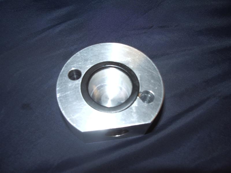

New picture of Machined collar (supplied by Jon Mitchell) that will replace the AAV Plate (Auxillary Air Valve Plate) on front of plenum to allow some lateral aiming of the Nitrous/Fuel nozzle into the plenum by turning on the side thread.

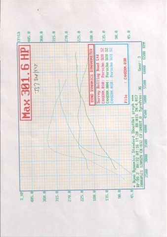

Hi All :)

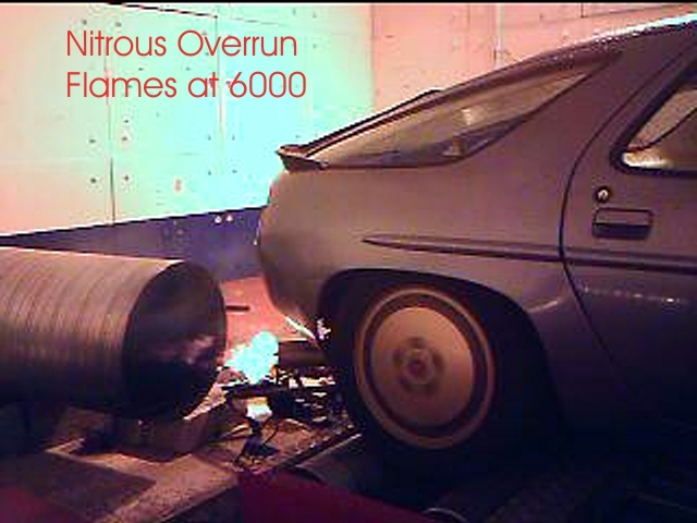

1..Dyno chart showing..71 hp increase on 75 hp jetting and 120 ft/lbs Torque increase !!!!!!
2..Mirror image (dont ask why lol) of NOS flames on overrun at approx 6000 revs....which is
exactly what happens when it pops at same time on road lol :)
Apologies for quality but the frame capture was only 18kb.
Will increase jetting to 100 hp this week and move to a colder plug (going to BP7ES from BP6ES)
Then will dyno again...
All the best Brett :)
Hi All
Another update...
Fitted 100 hp jets today...also discovered why my 75hp jets only gave 71hp (on dyno)...it was a 70 hp jet lol
