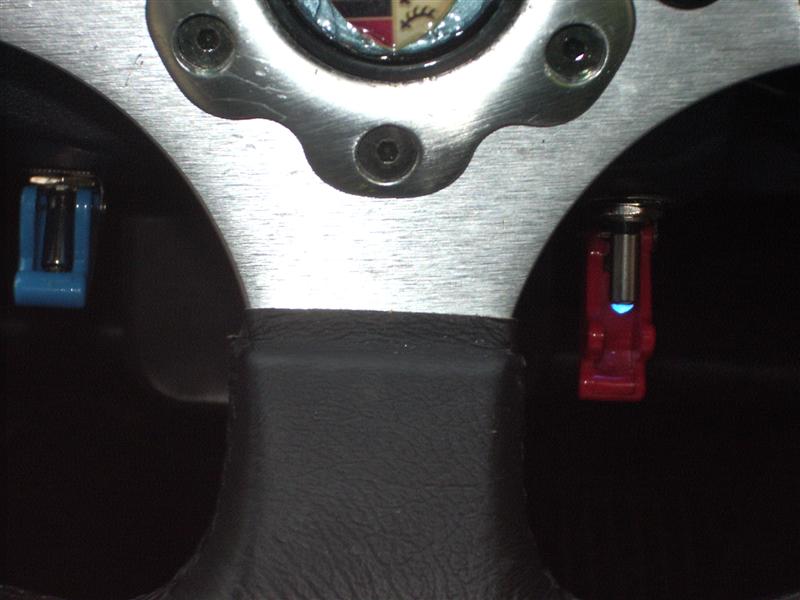

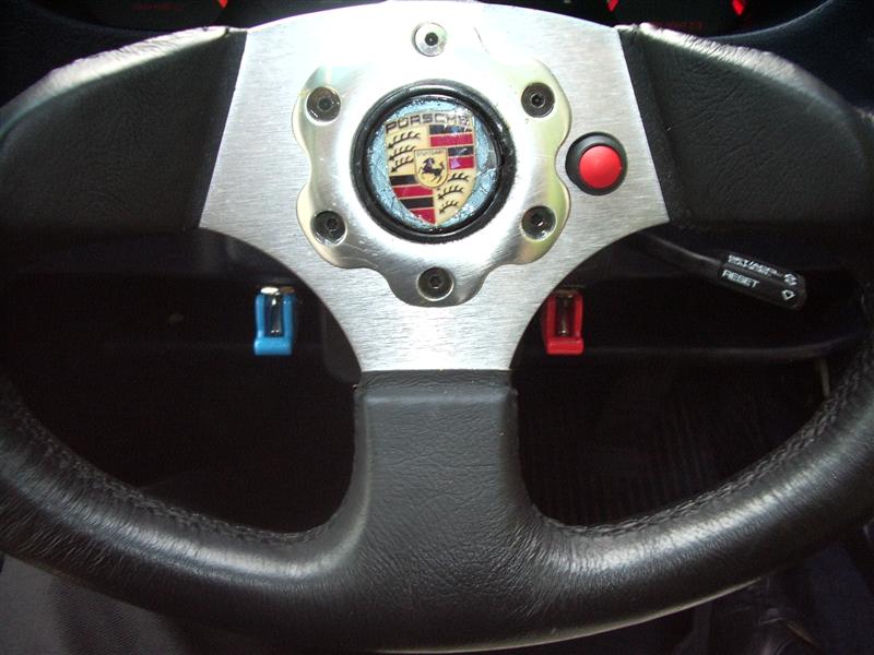

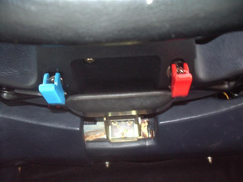

1....Wheel with BLUE NITROUS safety switch on left and RED Wide open Throttle safety switch on right.
All the best Brett

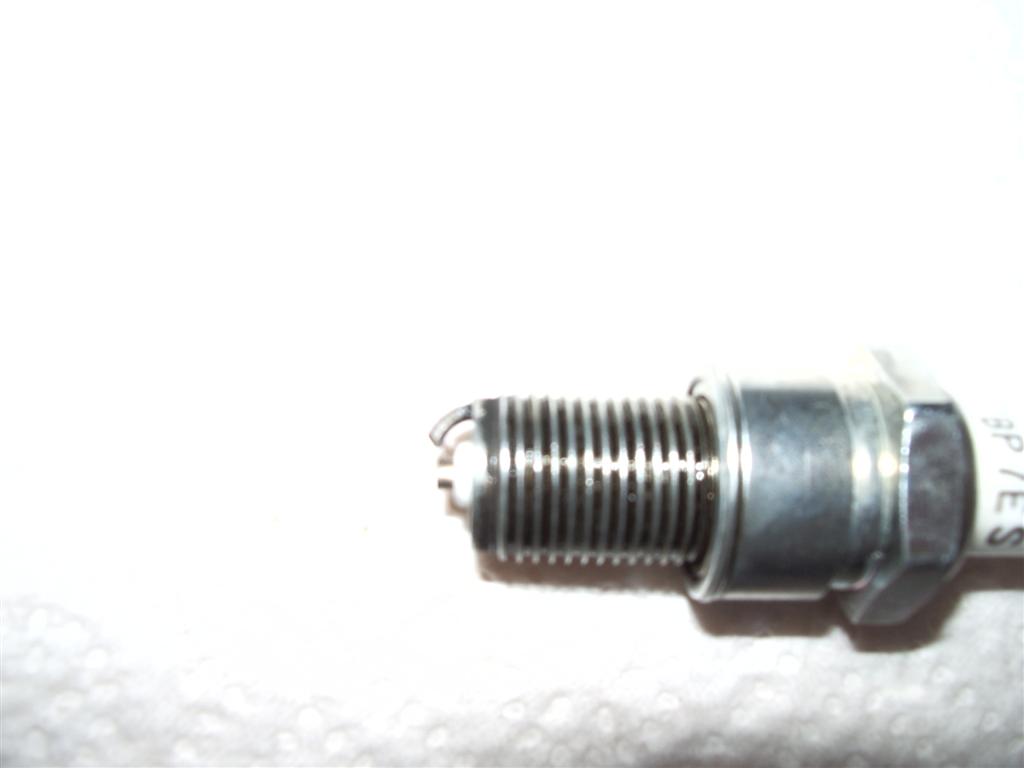

Picture update...My "home grown" plugs for Nitrous...
NGK BP7ES...one grade colder than normal BP6ES
Side electrode ground off to stop it becoming a glow plug and burning a hole in pistons... lol
Side ground at 45 degrees to improve flame front...
Second picture in next post..........
All the best Brett

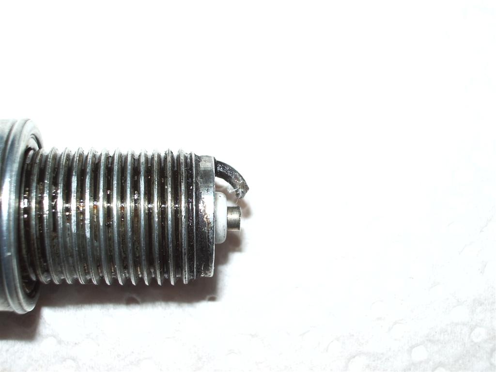

Second picture of plug...
All the best Brett
