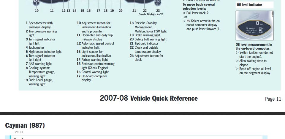

Steelback said:Do you check your oil level from cold or after the engine has been warmed and left to settle ?
Even the "Cayman 987 2007-2008 Vehicle Quick Reference" does not state whether it must be done cold or warm https://www.porscheclubgb.com/legacy/clientftp/Register/996/misc/cayman/cayman07-08qrg.pdf. Perhaps it doesn't matter, is there a difference in the waiting time countdown dependent on whether the engine is cold or warm and does it make any difference to the reading you get?

Steelback said:Good evening all after a little bit of newbie advice please. Do you check your oil level from cold or after the engine has been warmed and left to settle ?
On my 987.1 Boxster I can turn the key and read the oil level from cold.
When I've been driving and I try to check the oil level, a countdown timer appears, and it could be anything before the car will let you check.
I've had counting down from 55 minutes sometimes.
Sometimes its 6 or 10.
I tend to check it cold and see where the level is, and I check it when up to temp too.
For example I filled up with fuel, went in the garage, bought some stuff, paid for the fuel, went back outside, got in car and it allowed me to get the oil level straight away.
If its one bar off full I'm reasonably content, it's never gone below.
I think I've put < 1/2 litre of oil in during 6k miles.
AndrewT
From what you've said it sounds as though the 987.1 oil level is best checked with the engine cold, or at least below a certain temperature, and that the countdown operates while the engine temperature is decreasing until the correct measuring conditions have been reached.
It always seemed a bit odd to me that you cannot check the oil level in a 987.2 until operating temperature has been reached, after all what would happen if there was little or no oil in the engine (apart from it seizing!)?
