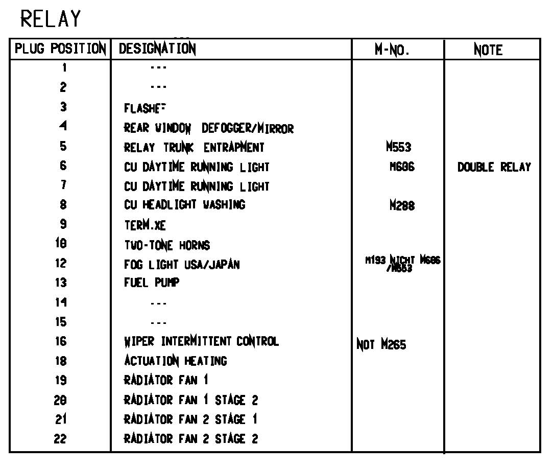

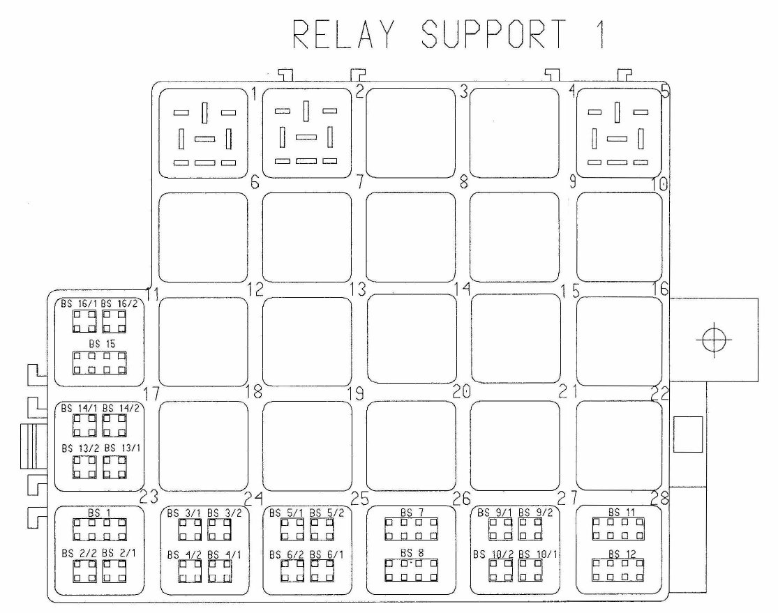

NXI20, i just had a look at relays, i need more of a description if you could, the relays are staggerd and when i look third row down, third across its a blank, is it a different type to the others for easy identification, sorry about this, Lee.
What year is your car - the diagram I looked at was for a 2003. It may well be different in the earlier cars.
Just had a quick re-read of the wiring diagrams & it seems all model years are the same in this regard. The diagram takes a bit of interpreting & I misread it first time around.
The relay position is actually the bottom relay on the leftmost second row of the staggered part. The part number of the relay is 996.615.101.00
Hope that's a bit clearer now.
"The relay position is actually the bottom relay on the leftmost second row of the staggered part. "
Hi NXI20, lol, sorry mate but i havn't a clue where you mean mate, could you possibly just give me the link where you saw it for location of the relay, cheers, Lee.
Umm, not really as it's a PDF of about 8Mb. I can email it to you if you give me your address.
Here you go:
Position 13 is the fuel pump relay.
Thank you very much Richard, great help, Richard if i took that relay out and swopped it for a identicale one in the box, say headlights or whatever isnt really needed is that ok, thanks again, Lee.
NO - unless they have the same part number (as Nick quoted above) then they won't work. the part numbers are printed on the top of the relays.
