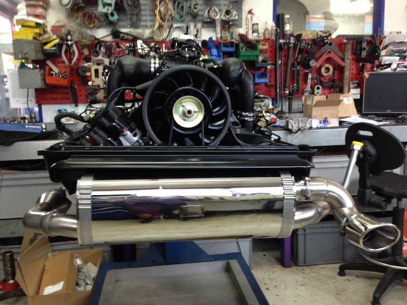

Here is a picture of system mounted on new motor right before it was installed.
That's just lovely! I'm driving kids around, so actually am leaning towards going with oem exhaust with sport cat and cup pipe; might regress to just oem with sport cat if that's too much.
