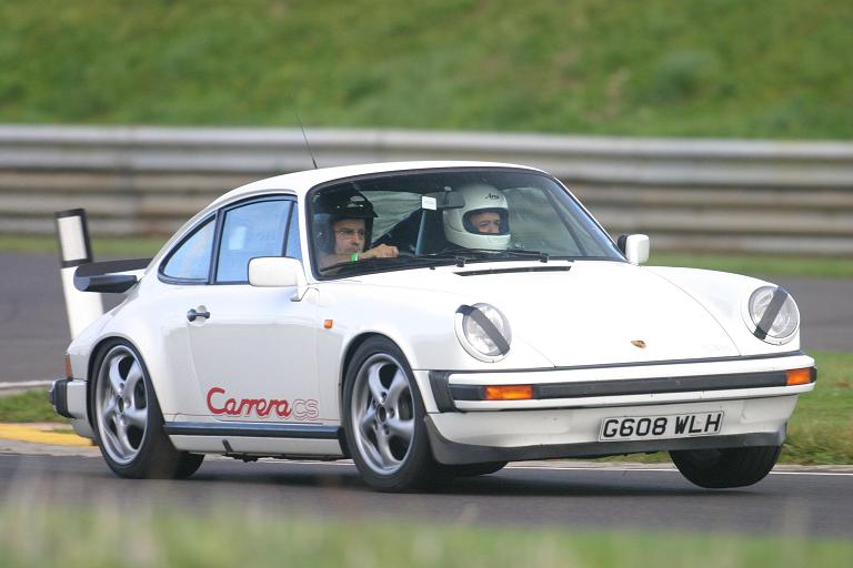

You can see how tight the 225/45 on a 7 is on the front and also the clearance with 245/45 on a 9 in this photo. I have posted plenty of other photos showing the car in corners with the suspension at maximum compression giving another perspective on clearance.
