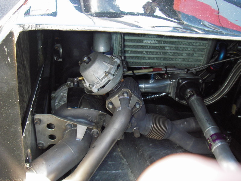

I wouldn't disagree with you (well I do sometimes) but the TiAL is a bit of a sod to keep in place because of the reduced number of fixings on the WG and the need for adaptor plates. They are great while they are working though.
I'm not convinced on the MBC. On the dyno Beaky achieves the set boost which then starts to decay immediately, in a very linear fashion. This is also apparent on other Turbots fitted with MBC's. I don't know what the alternative is, aside electronic boost control, but I had considered re-installing my Reliaboost - if I've still got it - to see if this reduces the decay. Granted I've only got a baby turbo, and one would expect decay as a result, but the decay seems too linear.
I have flanges welded on my exhaust to suit my (admittedly 46mm) TiAL, and I have to say I don't know why none of you guys struggling with adapter plates don't do the same. I'm pretty sure TiAL intend the WG to be bolted to the correct flanges without adapter plates and (as with the brake caliper adapter plates) they are not a very good solution it would seem. Simon at ESS even sounded intrested in fabbing an ESS system with TiAL flanges when I spoke to him at the RR day so he might even get it done for you FOC if you ask nicely and he can use your's as R&D.
