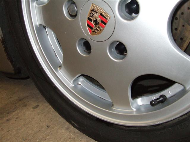

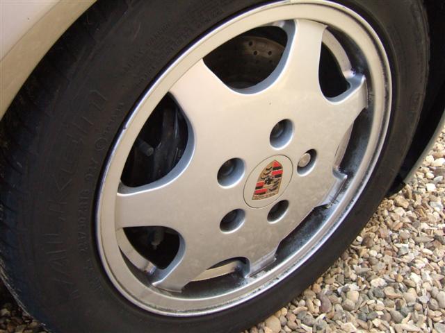

This was taken AFTER washing the front wheels [&:]
An hour (yes, one hour approx per wheel) later and a toothbrush and `Wonder Wheels` and there are still deposits on the wheel that wont come off .
Methinks I am going to use the D90`s as track wheels and get some Cup 1`s as everyday wheels.

I've only just had a chance to try my pfc 97's but yes they are fantastic, can only really compare to EBC Green, but way better street and track.Little concerned about the hot metal thing, but didn't notice any damage, body work is really my concern, I have black anodised track wheels
If its hot metal dust it can only get worse!
I`m not sure why it happens though. Other pads on other cars I`ve owned all get hot, one set wore the discs out quicker than the pads so presumably was coating my car and wheels with metal dust but the dust was still a wash/wipe off??

Finally try not to use Wonder Wheels on any wheel that you value. It really is highly corrosive and you will soon have no lacquer to worry about as well as those hot metal bits [:eek:]
I'm quickly going off wonder wheels as well. It works a treat but i'm also worried about it's corrosive effects on other components like brakes. I noticed that after using wonder wheels over the period of about 12 - 18months it gave my older calipers a white-whash effect. A closer inspction has revealed that it has stripped the black paint (or whatever coating the calipers have) ane the white wash tide-line effect is where boundry with the bare caliper material meets what paint is left. I'm not going to use it now i've fitted my big blacks. Incidentally my rear calipers seem unaffected but I think that's because they are buried deeper in the wheel and probably never comes into contact with the stuff.
I now use a plastic pan scourer to attach those awkward and stubborn brake dust deposits. The corrosive effect of the PF pads is a worry and is the prime reason why I stuck with EBC's even though I wasn't 100% satisfied with them. I was coming round to the idea of fitting the PF pads.

Its clear that they get really hot on track and obviously stay hot but I am still amazed at how the PF pad powder burns itself onto the wheels as most others dont???? and today I `may` have noticed something significant.
The day and roads were dry BUT I had gone through a couple of minor puddles and a couple of drives where people were washing cars and the run off was in the road so when I went to clean the wheels the dust came off fine EXCEPT where the wheels had a few splashes on them Interestingly at Bedford it was v v wet at first and only dried up after noon. Hmmmmm....strange

I'd say it has definately something to do with them being used in the wet.
The first time I used them it was only at the ring, in the dry. The second time was as more daily transport including wet days. I used them on the Clio on a 450 mile wet trip to the ring. The damage was clear after we arrived.
I dont know why this would be........but there you go.
Assuming the PFC's are the same as my beloved Porterfields then on my experience I would recommned using one of the coatings designed to prevent dust brake dust from sticking before driving anywhere. I think I use a Turtle wax one that comes in a bright green spray bottle and take extra care to ensure good coverage of all the leading edges and dust traps. I have also tried Zymol wax on the wheels with similar results, but find the former easier and cheaper!
As long as you wash the wheels thoroughly soon after a track day then it should come off very well, and I would definately agree with Dave about not letting them get wet, the particles seem to rust on and then need a lot of work to remove (with a toothbrush and an acid based cleaner in my case - however please note I'm not that worried about the appearance of my wheels as they're just badly home painted).
As regards it sticking to paint work, on my white car you can see the residue clearly building up on all the exposed edges of paintwork. Best to wash it off as soon as possible otherwise it will again rust on, however a clay bar will soon get any traces off, even after this. After a few thousand miles of this treatment I have not noticed any long term problems with my paint, although I suppose it's possible that clear coated paints might suffer more.
