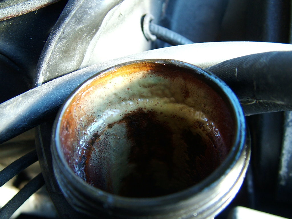

Just been under the bonnet and found out that there's been some radical changes to oil filler since i last checked it about a week ago or even less(when it was completely dry)..
There's no sign of coolant on oil dipstick or noticable coolant loss yet but the engine is getting hot faster than before..it looks like the radiator incident might have damaged the engine after all..what i can't understand is why does it always happen to me..very sad now..don't quite know what to think..[:(]
don't panic it may just be some residue in the block that is gradually making its way out. It doesn't look a lot . I would just wipe it clean and monitor everything. If you were losing a significant amount of water then yes you would be right to worry but you say you arn't .
You could always get the local garage to do a leakdown test. Shouldn't cost much if anything and might confirm things !
Whats the history ? did you have a H/G failure ?
No head gasket failure as far as i know..i've got a comprehensive pile of invoices and old MOTs..several service invoices describing the car as "very good condition for age"..
It seems to me that the troubles started after Silverstone Classic "parade" laps..i don't have chance to take the car on track very often(at all) so i pushed it a bit more than usual..so the next day after leaving Silverstone i broke down because radiator failed - i just noticed at one point that temp gauge was on max and pulled over..found out that all the antifreeze had leaked out and when i tried to top it up with water it came out as fast as it went in..so fetched the car back home on recovery truck..changed radiator the same day and had a 350 mile trip next morning with no problems..then just 2 weeks ago got stuck in traffic on M1 and the fan was constantly on..just less than a mile after i came off M1 i heard a big bang and then engine cut off..pulled over and found out that the rubber bushes had failed to hold radiator in place - the top end had fallen backwards so cooling fan came in contact with water pump > radiator hose and rubbed it until it gave up..so i patched it up and replaced the next day..but ever since this trail of misfortune i have noticed that it only takes a few miles for temp gauge to reach 1/4 and the "normal" temp is somewhere around 1/2..
The fact that you lost all the water and subsequently managed 350 miles in one go without problems would suggest you are OK from that one.
The temperature gauge going to 1/4 in a few miles, and settling around 1/2 is not wildly unusual, is it? Sounds pretty much like mine.
And that's not a lot of white sludge in the filler cap. It's no more than a trace.
A few short journeys can cause enough condensation to have this effect.

ETA: A compression test would identify a duff head gasket immediately. And would set your mind at rest. Well worth a try.
mmm good discription. My guess is that before these incidents your temperature would stay pretty much at 1/4 (lowest ) yes?. All three of my 944 would reach operating temperature quickly (within 3-5 minutes) thats the design because the engine runs more eficiciently at normal operating temperature. If the guage is normally at 1/2 way it shouldn't be a problem providing you keep a careful eye on it . I personally find it worrying when the guage runs that high normally. There is a special rated thermostat with a setting for cold climates that operate at 1/2 on the guage (ask me how I know groan )
Compression test won't tell you much in this instance as you are looking for a water leak rather than an air leak from the cylinders, so a leak down test would be more diagnostic. (Basically your coolant system is pressurized and checked over a period of time for pressure loss.) If you are gradually losing pressure in your coolant system the water will boil at a lower temperature.
I would be tempted to check all the coolant syatem hoses and possibly renew clamps where suspect , at least go round and retighten all hose clamps. It might pay you to connect a short piece of hose say 1 meter and raise it above the car when you refill the syatem . It should help to eliminate air . 944 are notoriously difficult to bleed correctly.Theres a tech file on it somewhere ,maybe Clarkes Garage or Pelican

looking on the worse side the overheating incident may have caused your water pump impellor to become loose on the pump spindle
Temperature was around 1/4 in normal town driving and i before these incidents i can't really remember it going over 1/2 even when stuck in traffic(exept when i warmed engine up on idle for testing)..driving on motorway - well..below 1/4 it usually were..[8|]..and i was quite used to it..ENGINE NORMAL OPERATING TEMPERATURE..that's a bit funny now..i have never really thought about it..what is the normal operating temperature for early '85 944 2.5 8V? And how do you know about that special rated thermostat?[:D] I've just started taking the Zermatt Silver car to bits - it didn't have a thermostat at all!! What's an impellor(i'm still learning)?[8|]
Just been in a garage but they were so "busy" that they didn't have time to have a look today..so we just had a 10 minute chat..answers considered -
a) some engines like to get hot;
b) the old thermostat might have been permanently open(actually i tested the old thermostat in boiling water - it didn't open at all..but i might have damaged it in removal process);
c) the mayo in oil filler could be just condensation..

Now the facts after i've been thinking and browsing around:
NOT ONLY IS THE NOT SITTING TIGHT IN THE HOUSING..IT'S THE NEW TYPE THERMOSTAT(FOR NEW WATER PUMP) AND IT'S OPENING TEMPERATURE IS 87c INSTEAD THE 83c USED WITH THE OLD TYPE PUMP..now that sounds like a pretty good reason to me..
Bought an antifreeze/coolant tester today..and found out that the antifreeze is quite weak as well..somewhere between -19c and -21c..that i'm sure plays it part..
Already phoned Sheffield OPC this morning and ordered a new thermostat+gaskets..due to bank holiday weekend will expect delivery next wed-thur..plenty of time to shop around for antifreeze..
But as it is nice and sunny today i will make myself useful and go check all them hoses

It looks like that it was a false alarm - wiped the oil filler neck and just did over 50 miles today - it's still dry..no sign of water..altough it still seems to be running a higher temperature than i've been used to so far..in normal traffic the gauge stays in middle or just a tiny bit below but goes up to 3/4 pretty quick at traffic lights/slow traffic etc..hoping to put this on the wrong thermostat/gasket and weak antifreeze mix..should find out this weekend..
Don't see how the concentration (or lack of) anti-freeze solution would make much difference. The specific heat capacity of water is slightly better than ethylene glycol and therefor pure water would be a better absolute coolant than an anti-freeze mix. Of course, your engine would corrode badly and freeze in the winter...
I think you have a thermostat / air-lock issue.
