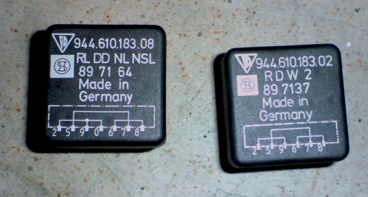

I thought it might be better to resurrect this thread than to start a new one.
I've just done the above modification, but it didn't work for me.
Sure enough, switch to sidelights and they come on without lifting the headlights. Great. But, switching up to headlights, they still don't pop up. Damn.
I checked and double-checked, I've removed the connection from the dim-dip unit and all my link wires are in the right places where relay G6 used to be. I've double-checked their positions against the photo posted by John.
But the headlights no longer work.
Has anyone got any idea what might be going wrong? For now I've put everything back to normal and it's all working just fine.

That might be worth thinking about actually, the spade connectors are not as long as the pins on the standard relay. I wonder if I can get longer spade connectors somewhere to try instead?
As luck would have it, I found an alternative G6 "˜relay' in the back of the garage half an hour ago. Photo attached, showing the standard '89 relay and the older one I just unearthed.
On the left is the standard '89 plug with definite dim-dip behaviour.
On the right is the other plug I found in the bottom of a spares bag.
The diagram on the other plug seems to match the home-wiring job I've been trying to do, according to the instructions that seem to be working for everyone else.
So, I popped in the older G6 plug and disconnected my dim-dip box under the dash.
Still not working as it theoretically should. Same result I had with my own bridging wires.
At least that tells me that my problem isn't my spade connectors being too short. It's something else. I also now know that with the modification my headlights are coming on when I switch 'em on, they're just not popping up.
This was meant to be so easy "¦ *sigh*

Apologies for resurrecting this thread but can anybody confirm that they swapped the original G6 relay for the non-88/89 one and in conjunction with disconnecting the box under the steering column this worked?
