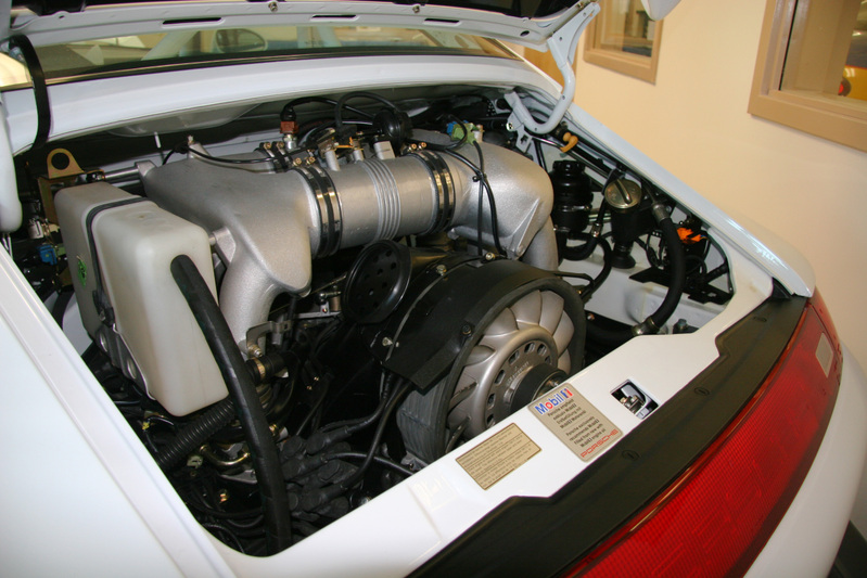

interestingly Frere quotes the "RSR" version of the 993 engine at 340ps . Just a thought but the main difference would be the intake system, varioram for the 993 and individual throttles for the 964 ?![8D]
Not sure about that Laurence.... varioram on 993RS, but not on 993 cup or RSR....sounds like they needed a better proof reader.
Here is a pic of a standard factory 993 RSR which was rated at 360bhp........note it does not have varioram in the real world, only in the written word!
actually the book did'nt say varioram , that was my mistake. from the book again under the heading The 911 cup 3.8 RSR (993 for clarity) "m64/80 engine which operates with an 11.5:1 compression ratio is a development of the engine which powered the 964 series Carrera RSR . It features a reasonance intake system electronically controlled by a flap valve , and six seperate throttles located near the cylinder heads, a system ensuring immediate throttle response."
Development of 964 RSR lump......360bhp vs the 340 of the 964RSR.....I have been told this by a chap who used to look after these cars in race teams when they were new, who clearly knows more about them than us!
I wouldn't be suprised if there are late 964RSR running the developed engine though.......both race engines though, so not the engine lifes we require.
