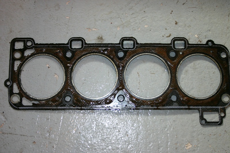

Just stripped mine this weekend and the head gasket was rotting away. I must admit, I was doing the head job for other reasons (low compression due to valve seating) and would not have stripped it just to do the head gasket.
Edited to add picture showing how gasket had rotted around number 4 cylinder but also becoming porous just about everywhere else. I know the gasket is at least 19 years old and probably original.
