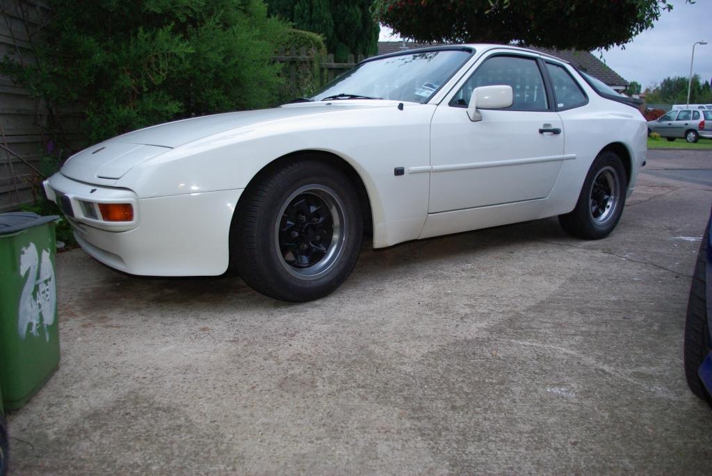

[/IMG]
I have cup 1s and they are 17" which sets the car off great.[:)]
I do love those 18s on Andys though![8D]
the only car that looked good on 18's was Nick Appleton's- same wheels as Andy's but a 30-40 mm drop made them look much better

( stop dont shoot dont shoot). Those Blue cups to me look just right despite not 'filling' the arches , what size are they ?
Regards Mas

Pauly, the car looks great![:)]
I was on the look out for some 17" Cup 1s for my old car, but having found some (albeit replicas, which incidentally are only ounces heavier than the real deals 'cos I weighed them, so don't believe the 'boat anchor' stories[8|]) but having bought some, I them bought a 'Beetle' as well....[8|][:D]
I think the gorgeous arches of the 944 need at least 17" to fill them adequately (personal opinion, before Scotty loads his shotgun[8|]) but I also happen to love the look of the standard cars on the D90s/forged 16" rims.
Pauly,
What wheels are those ? they look supberb are they 18" ? i drove a late model turbo on 18's once though serious tramlining issues.
