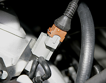

Also, when you get it - disconnect the brown connector plug and it will be loud all the time - right through the rev range - much better.[:)]
This is it:

A quick question, if I have the PSE installed complete with the in cabin on/off switch by my OPC and then disconnect the brown connection to get PSE right through acceleration will I still be able to use teh switch to switch it on/off?
I think you'll find the brown connector is carrying the signal from the in-cabin switch to open and close the PSE bypass, so the answer has to be 'no'! I did hear from someone that the valve likes to be operated from time to time, presumably to discourage sooting-up, so I guess it's a good idea to connect it now and again.
