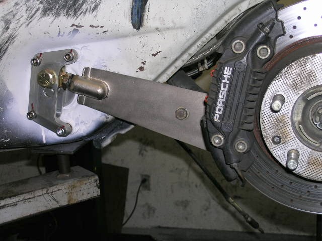

If you are replacing spring plates you may want to upgrade to ERP plates with Heim joints. Have attached a photo. Follow the thread:
http://forums.pelicanparts.com/showthread.php?perpage=20&threadid=207216&pagenumber=5
There's also the front through the body anti-roll bar typical of earlier cars with adjustable links for tuning of a/r stiffness and fine corner weight balance tuning.

That won't work. You have to go to coil overs to use the 935 style spring plates as they have a billet insert into the torsion tube to locate the springplate. There is no torsion bar in this set-up and the insert is to take pressure/load off the four mounting bolts on the springplate cover. You also have to reinforce the rear strut towers if you go to coil overs.
What you want to do is replace the OE rubber bushings with Neatrix rubber bushings while the torsion bars are out or, even better, replace with Elephant Racing polybronze bushings.
