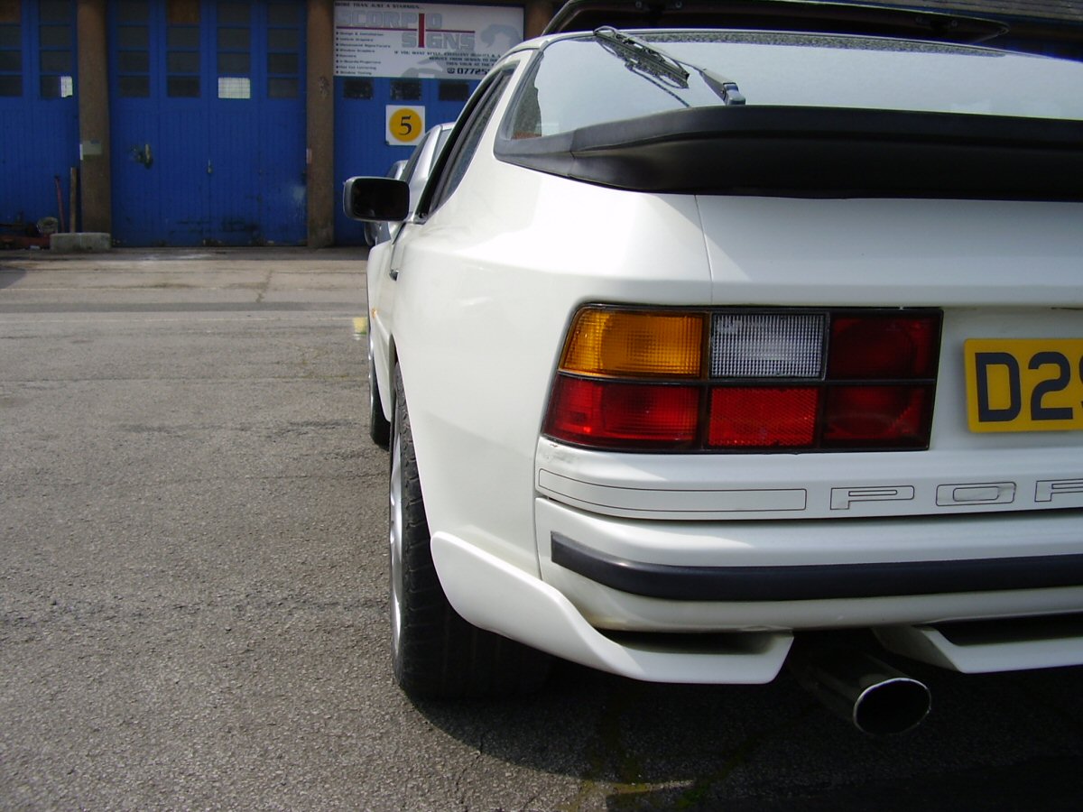

I have actually been debating whether or not to get some other wheels for it but they really suit it [:mad:] so I am a bit reluctant to. Maybe that will be the only thing to do.... one thing does spring to mind? Would it be any better putting narrower tyres on the backs? I doubt if that would make that much difference though if I am thinking correctly. I have added a couple of pics to show the wheels in the arches.

looks real nice. How the heck do you keep that colour looking so clean ?!

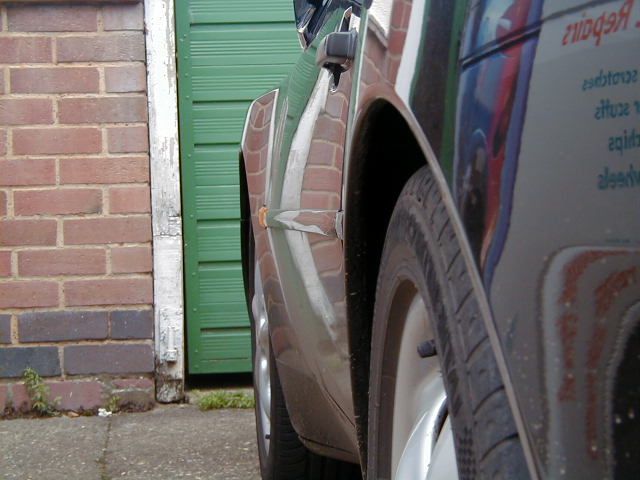

You don't say what size the rear wheel and offset is (stamped either side of the valve) but if it's like mine I am guessing it will be 8.5" wide and offset of 50. This should fit a late offset car with no problems, here's a quick pic of mine on an S2 that doesn't have rolled lips.

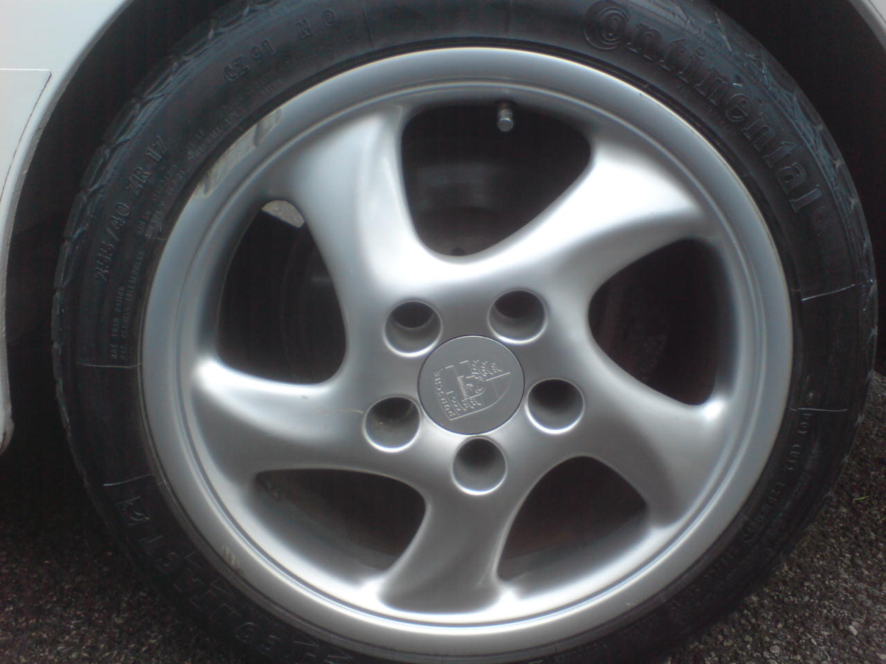

I think we need to see a clear picture of your wheels as it is unclear from the avatar pic exactly which ones you have. Genuine wheels will have the width and offset stamped by the side of the valve, aftermarkets are blank.
I am guessing that you actually have aftermarket Cup3 wheels and not Boxster twists. As far as I am aware there are no aftermarket Boxster twists so I think you have aftermarket Cup3's with an early offset, yet you have one of the changeover '87 model cars with late offset hubs. This is the only way I can think your wheels stick out so far
These are Cup3s also called 'Turbo look'
These are Boxster twists also called 'Carrera 2's'

Ok, from those two pics posted it would appear I have got the aftermarket cup 3 wheels. I will try to get a couple of pictures of the wheels and post to confirm but that definitely sounds like that's what I have got.... damn!!
