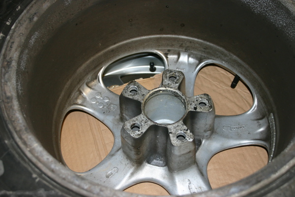

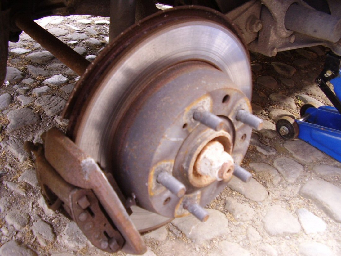

Next installment of the wheel scrubbing issues.... It would now appear that I have been barking totally up the wrong tree...... have just removed the wheel and checked the offset printed on it...... it is ET15!!!! I have posted a pic of my hub as well but I am now presuming that I have late hubs and early wheels???
here is a photo of the inside of one of my rear rims (early offset) these are ET15 they fit my car perfectly it is a 1986, the ones that were on say too far in and were et50 (still have these in the garage waiting for a good home)
It was only certain corners but seems to be a combination of the tyre, lack of clearance in the arch, and the wrong offset
