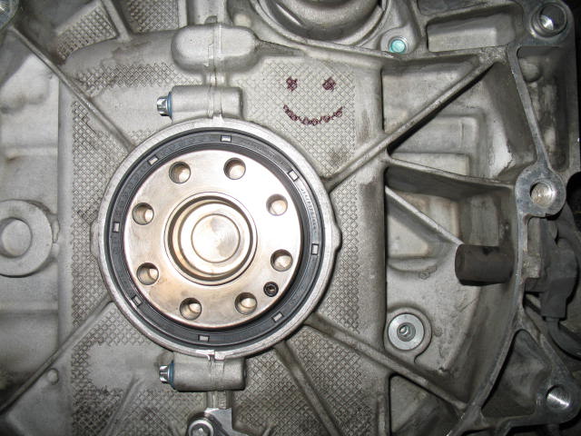

When you are ready for the next attempt to reseal your motor, look for a happy face.....

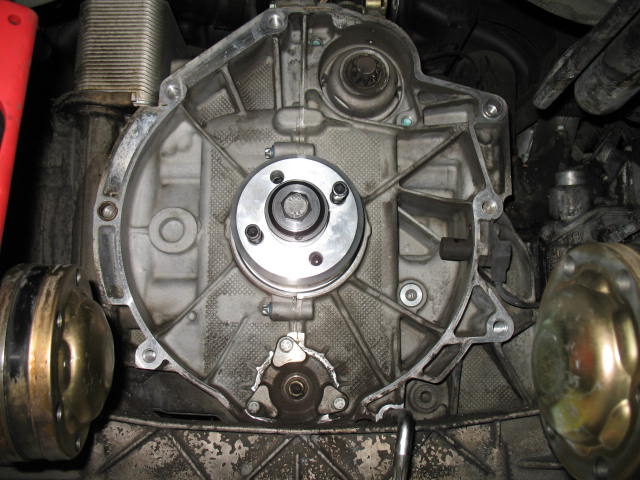

But in fairness not all M96 motors leak. I took this picture yesterday of a 1999 C2 with 140,000 miles. It was in for a clutch replacement, this being the second replacement. The engine had no leaks. Due to the mileage the owner elected to have it re-sealed anyway. New 997 seal - the tool to install it is in place in the picture. Intermediate shaft flange/seal. Blue case bolts and blue bolts for the flange.
Now watch. With Murphy's Law it is going to leak.
