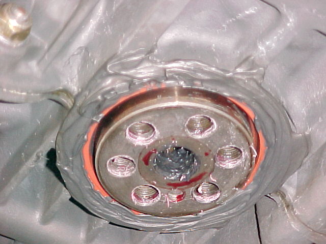

I've often wondered what seal Berny had fitted. He told me that it was the GT3 Motorsport seal, fitted in reverse. I never thought this was correct, because they are different sizes:
996 - 85x105x11mm
GT3 - 90x110x12mm
Maybe it was the new 997 seal, just fitted backwards. Apparently it's an old trick that works. I've had it explained to me, but I can't remember at the moment. I'll have to ask again and report back.....
996 - 85x105x11mm
GT3 - 90x110x12mm
i thought it was the motorsport seal in reverse too - i'll ask him again at the regional meeting on Wednesday.
