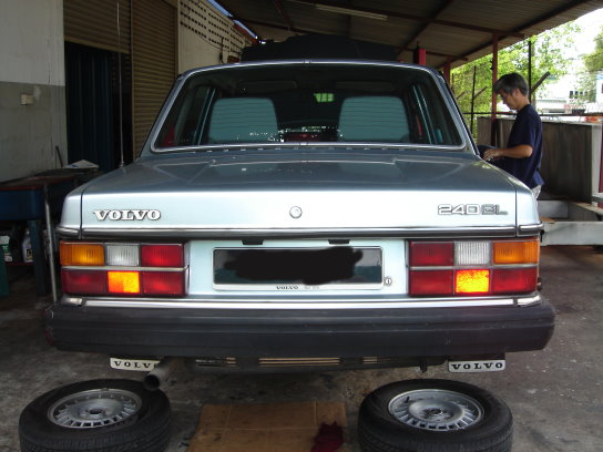

Going by the image of that 320, A combination of red lenses and these LED bulbs might work?

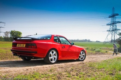

Well I thought I'd update this thread as I've just finished tinting my lights.
I originally bought the vinyl from ebay (above). It was ok but didnt completely cover the orange, and it had a slight pink tinge to it. So not the best quality.
When I tried the indicators they flashed red not orange. But once I swapped out the orange bulb for green led, it was bright orange again, you couldnt tell the difference from stock!
In the end I took the tint off as it was poor quality.
I then decided to go down the route of spray tint. After some reading up on the legality of red reverse lights and legality (just remove the bulb and it will be road logal and pass an MOT). I decided to tint darker.
So I've tinted the top half of the lights darker. I know this wont be everyones cup of tea, but I really cant stant the standard Volvoesque lights.

tail and brake lights are both on the bottom row so shouldnt cause any problems with visability.
I'm just happy they no longer look like they're stolen from a Volvo.

It was this S2 that recently sold on ebay that gave me the idea.
In hindsight I have probably gone a bit too dark.. but my personal opinion is that the tinted rear lights in this S2 look better than any combination I've seen so far.
