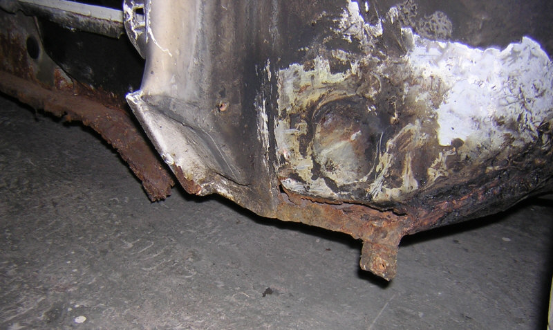

The corrosion is due to a bodged repair of the car prior to my ownership, which has resulted in the rear wing, inner sill and even the floorpan being rotten [:mad:] It's a bit worrying to think that there was precious little strength to right hand side of the car, an impact there could have been rather nasty.

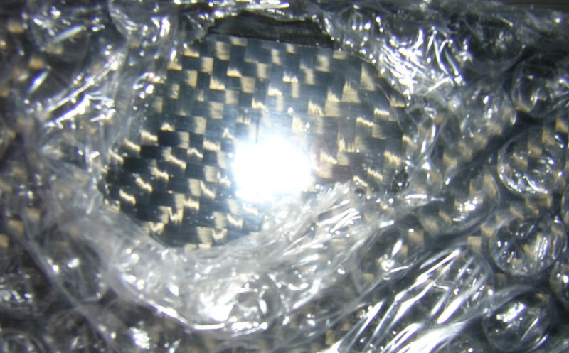

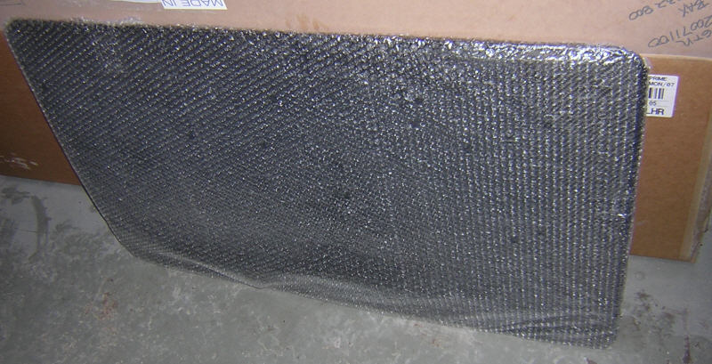

Onto more fun things, I've just seen the carbon sunroof panel that Simon at ESS got for me, it's fantastic [:D] It weighs literally nothing and from what I've seen is really nicely finished (I didn't want to unwrap it till we needed to). If I had a black car I'd leave it unpainted (you know you want one Mr Sims), and feel really guilty that it's going to be covered. This is a great weight saving and pretty cheap too.

George, you're right, it was heartening to see the genuine Porsche sticker on that panel [:D] It just seems they didn't paint any of it properly, there wasn't the correct undersealing applied either. Foolishly I had the underseal reapplied about 7 years ago when it became evident there was a bit of a problem here and this probably made it much worse (I thought I'd caught it in time).
Not sure why I took this picture, nor why I'm posting it here, but it's the only shot I got of the sunroof, even if it's still bubble wrapped.

I like the carbon sunroof - is that the GT racing one and do you think it will fit?
Yes I believe Simon got it from GT racing. I don't think fitment should be an issue, it looks straight and true and has some give in it to enable us to bend it if necessary. I think Alan at the bodyshop is going to try to blend it in seamlessly if it's good enough. I've decided to strip all the headlining and paint the inside of the roof now, I'll just leave the sunvisors, rear quater trim and A pillar covers in place, the rest from the carpets upwards will be just painted metal. I'm starting to feel quite confident we might almost completely offset the additional weight of the half cage and SC (nearly 50kg I guess). If only I could come up with a good solution for losing weight out of the doors without resorting to having to use door bars on the cage. :rolleyes:

First of all- good on you for having the car repaired!
I thought the rust was bad in the sills on mine, but a couple of small holes on each side was nothing compared to the damage on yours.
Its interesting that the repair panels are not too expensive. For the DIY restorer that would make a mechanically good, but rusty 944 a good project, compared to restoring a classic 1960's British car, the rust on yours doesn't look to bad a job. Maybe 3 months of spare time.
Keep up the good work, and keep the progress photos coming. Just goes to show, after welding, its vital to protect the cavities with plenty of waxoil! Looks like all they did was weld the panels in with the black transport primer still in place. Bad mistake!

Those round pressings in the cills (3rd image) are they removable rubber bungs ?
If they are it would be a handy inspection and waxoil treatment access point
[FONT=verdana,geneva"][FONT=verdana,geneva"]
Yes they are - I've had mine out and done the very same with dinitrol to prevent any future nightmares;
