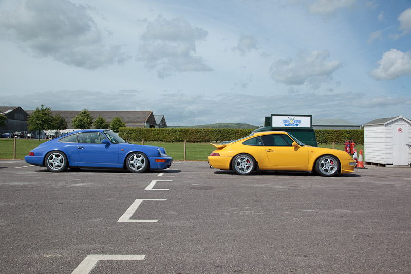

Or this one...(and its a nice photo too IMHO)
Ian, that looks pretty good to me ... if you an be patient I'll post a pic of mine ...
Yes I know they are 17" Cup 2's --- rear's are the same as the Mags in size, fronts are 5mm wider --- ET 65 with 15mm spacers ---

Gratuitous pic of a couple of Cup Cars below -you decide...

Does look a bit low at the front. As Melv says it must be a German thing as mine arrived from Berlin like that. It was wound as low as it would go.
