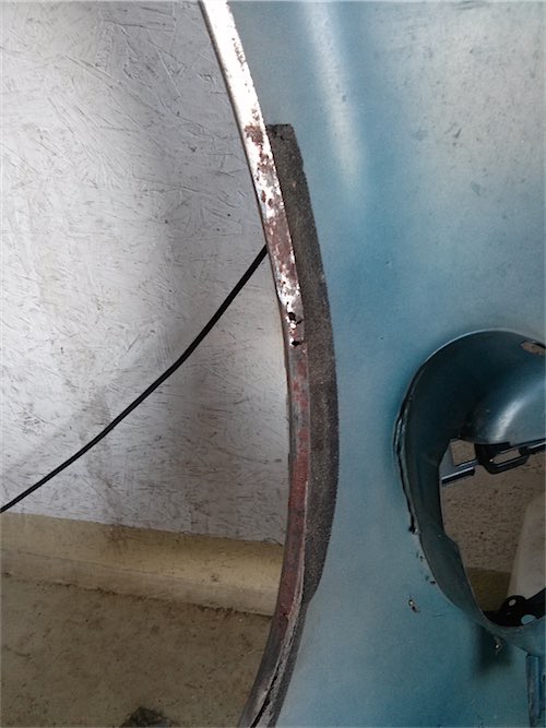

I had rust on my front offside wing - pic attached. I ended up putting on a new one... I think that strip of foam traps mud and moisture and really doesn't help at all... The rest of the car is fine (so far)...
