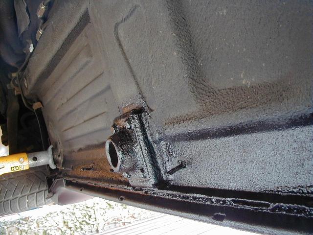

Oli, The third picture down in this thread shows the area of the front wing that is prone to corrosion
http://www.porscheclubgbforum.com/tm.asp?m=197053&mpage=1&key=wurth&#197053
It is the area underneath the 'bobbly' stoneguard paint that goes first, and at the bottom of this section are two lugs that the plastic 'under sill' attaches to. Alas despite all my efforts over Easter I have recently spotted an area of my freshly applied Stoneguard that looks like something is 'happening' underneath already [X(]

Paul, thanks for the link to your previous thread. Two questions. 1) You never posted the picture which you said you would of the drain holes which should be clear. Are these holes in the sill, or holes in the black trim which goes under the sill? I am confused (easily happens!) Also, 2), That is a VERY professional job - are you in the bodyshop trade? (If so, I may ask for a professional opinion and possibly a little work, if you are amenable to such things.)
Oli.
ETA: Another question, which I could find the answer to if I could be bothered to go and look at my car but it's dark and cold and I've got a nice glass of malt and am feeling lazy so I won't! ... the black plastic trims - are they in one piece which goes all along the underneath, or are they in two pieces - one under the sill and one under the wing?
(Edited again for bad smelling pistakes.)
If your lugs are still intact then do as Phil has done and get a load of underseal on them as these lugs are the first casualties. In fact I wouldn't be surpirsed if the spots of bubbling wruth that alot of us have experienced is rust coming through from were the spot weld was that attached the lugs before they corroded away.
Oli, I'll see if I can find that picture of the sill drains (it's on my old computer but I'm sure
I've got it). The drain holes are on the underside of the metal sill, you can't see them when the plastic trim is in place. The trim IS in two parts - one small section under the wing, and a 4 foot section under the sill itself.

Found it [:D]

Paul - thanks for the picture of the drain holes in the bottom of the sill. I'll be sure to take the plactic cover off and see if they are indeed clear. I guess I can use them to insert a waxoyl application pipe to make sure that the sills are really well coated inside - non? Also, what is a "S.M.A.R.T Repairer'? Pardon my ignorace.
