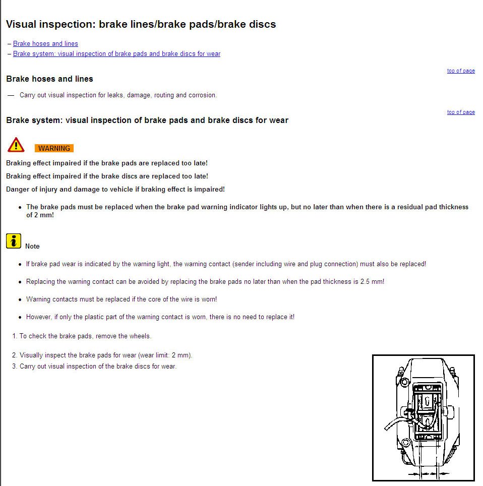

Yes. The workshop manual says "To check the brake pads, remove the wheels".

Conflicting answer then, Porsche Sheffield have just rung me back and told me no they did not take the wheels off it is a visual inspection and they could see the discs and pads were new.
I ask the question as there was a noise from the front drivers side wheel on my car on Saturday morning. I daren't drive it, so this morning I took it round the corner to a local garage who promptly informed me all the nuts were loose on the drivers side front wheel and simply tightened them up by hand in front of my eyes [:mad:]. So the wheel had been wobbling on the hub thats what the noise was. I am pi$$ed off to say the least.
It makes you wonder where they get their "technicians" trained. They obviously don't go by the book, and to leave the wheel bolts loose is incompetant.
I guess if they could see they were new, then they would not need to measure them.
However they obviously have had the wheels off or this wouldn't have happened [:mad:]
