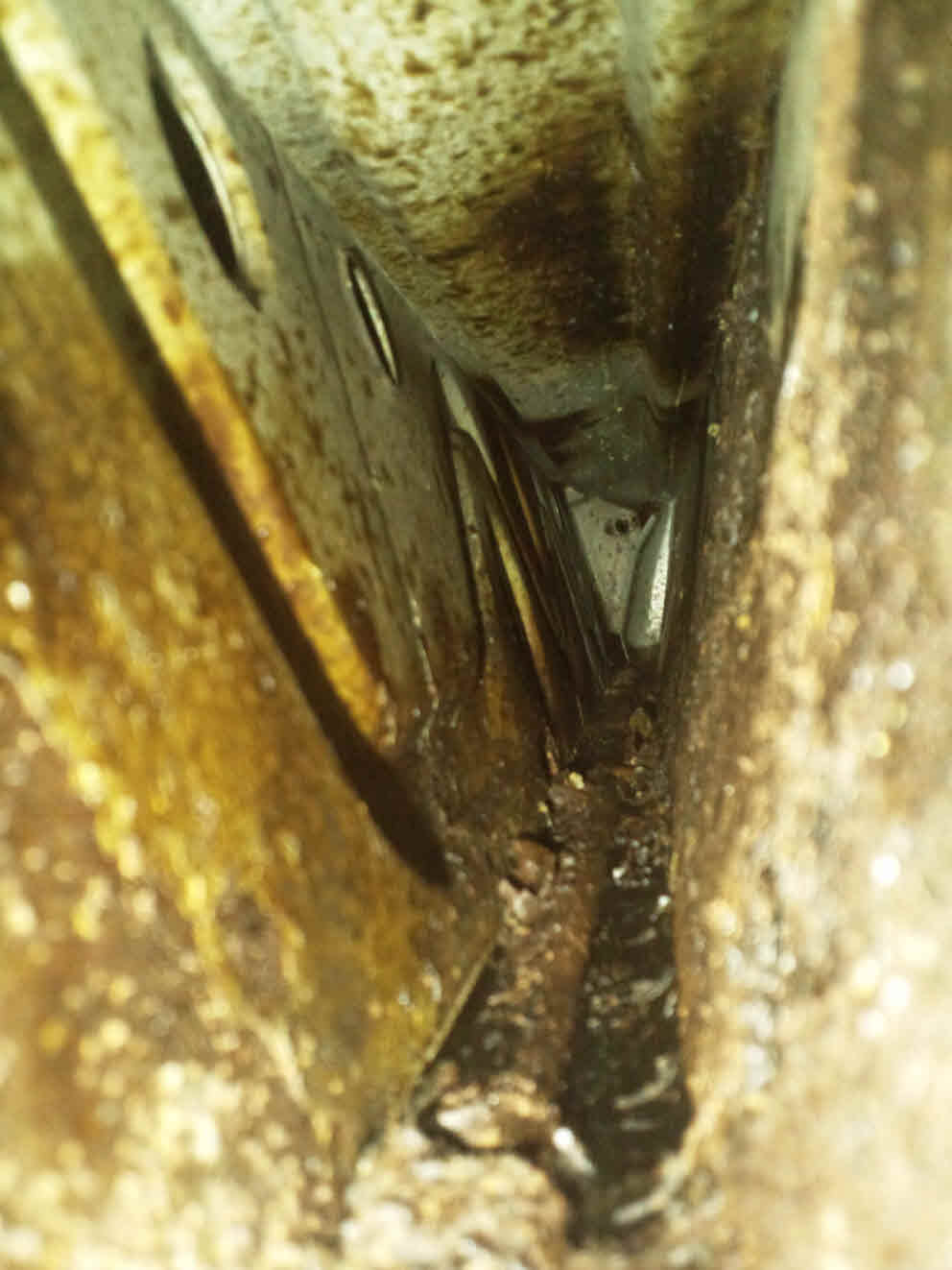

I used the same method when I did my sills last year and thought it successful. However I had a look again today using a mobile phone camera and was disappointed with the result. IIRC the brass jet on the end of the pipe has only 2 holes and I think that you don't apply as much as you think you are.
However, I am chuffed to see that the condition of the cills appears to be good
