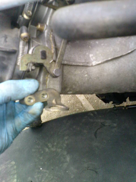

Found that the rubber grommet retaining clip was on the wrong way up on the throttle body - so removed and turned it the right way up (which meant that the grommet now sits lower and to the rear of the throttle body more).

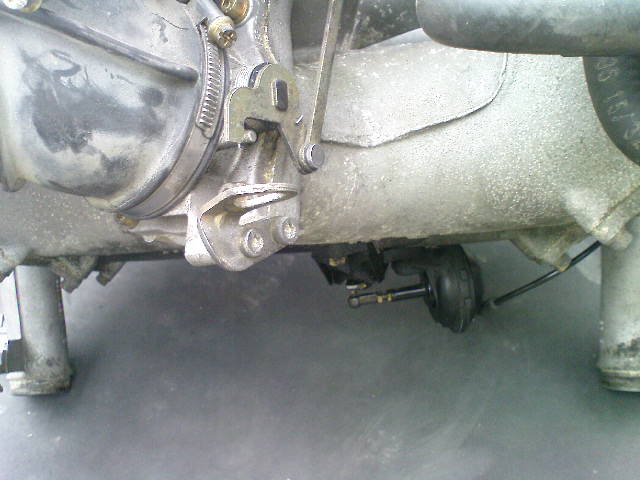

Did take some pics along the way with the mobile phone camera until it ran out of charge - so will try and post those on here soon. Got some good pics of the throttle body and grommet mounting, as well as the engine bay with the tract removed showing the two throttle cable routing holes.

Not sure if this will come out ok - but I have taken a pic of the grommet mounting for the throttle body shown the wrong way up - this was why the throttle could only acheive 44 degrees of movement.
and here is a pic of the throttle body grommet mounting shown the correct way up - which will enable you to get 84 degrees of throttle opening.
