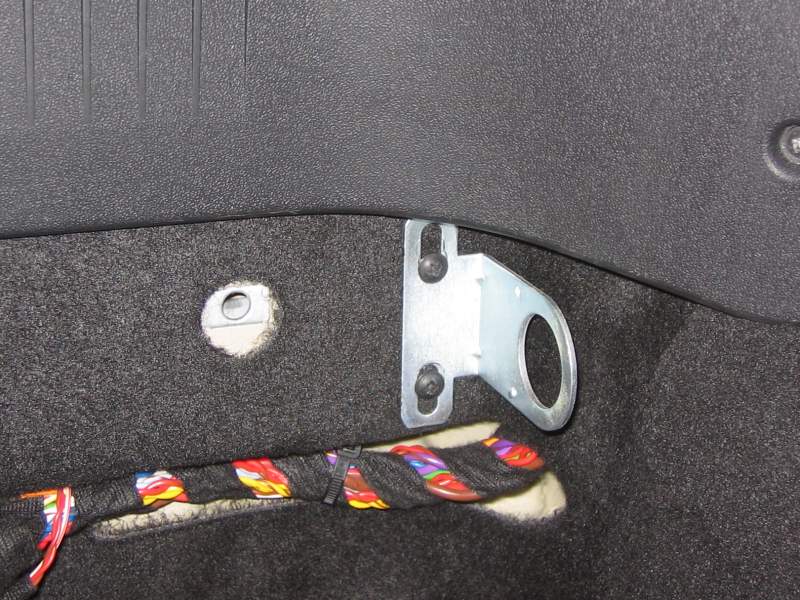

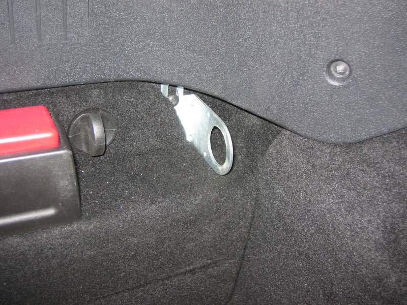

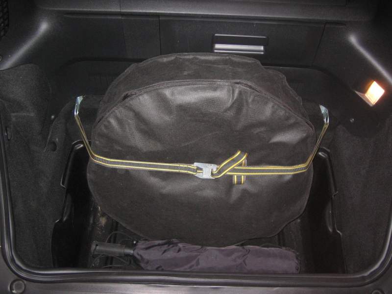

I managed to get a 996 C4 collapsible spare wheel (16" ET10 offset) from Porsch-Apart for £115 including a jack, delivery etc, which I thought was pretty reasonable, especially as they were in mint, unused condition. I already had a suitable socket and bar, and bought a cheap wheel cover on eBay for £9. I got a wheel locating tool and spare wheel poly bag from Porsche (under £10 for the pair). I also had some very handy brackets which made good lashing points in the front boot, so yesterday I got it all together, and here is the result:
The brackets are screwed to the box section behind with self tapping screws. If anyone is contemplating the same, I have a couple more of the brackets. Most of the time it will live in the front boot, but when we go away, it can be strapped to the engine cover, using the loops already in place. I checked it out, and it doesn't reduce visibility, by the way.
Reading on Planet 9, it seems that if I do get a puncture, a front wheel will also fit on the engine cover, but it isn't clear if a rear wheel will. If not, it will have to go in the rear section, and I'll use bungee cords to hold the rear lid down. Far from ideal, but in an emergency there doesn't seem much alternative.
Hope this is of use to someone.
