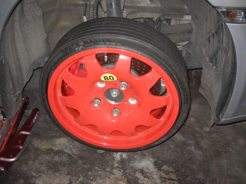

The part number for the 987C / Boxster is indeed a 996 part , I think its for cars with PCCB , but probably more to do with the wider tyres on the turbo and 4S making the rolling radius bigger and the need to keep the cross axle wheel speeds the same to ensure diff wear isn't an issue. Its certainly not the same wheel for the standard 996 / S . I've owned both the original 997/987 space saver and the 986 item , I eventually sold the 987 / 997 one because it was just too heavy and cumbersome to carry about. After damaging an alloy and tyre I was grateful for having the 986 space saver to get me home , so I have real world experience of when and where this device comes into its own. If the 16" space saver with collapsable tyre fits , thats great news, but Id still check carefully what tyre inflation pressure it needs to be pumped up to , and the limits of the OEM 987 tyre inflator. Porsche list a different tyre inflator specific for the collapsable spare on the 996 turbo. Personally I prefer the pre inflated 17" tyre as it saves time and hassle at the side of the road.
