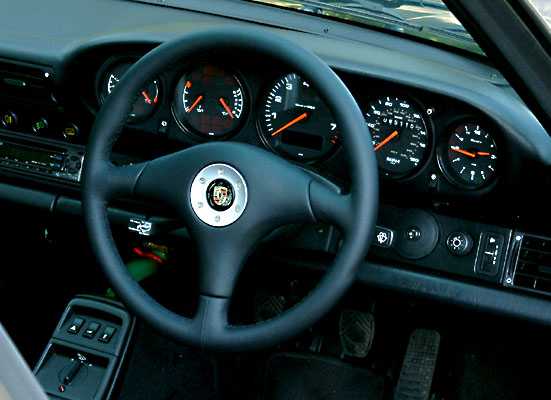

I have a Momo 07 that is the same as the race wheels Porsche fits to the 964RS, 964RSR, 993GT2 etc (picture below - sorry I do not have a picture in the car). It is dished 50mm and has a 350mm diameter. It obscures the instruments slightly more than the OE wheel. It is available in leather or suede in black or red. Most every Momo, Sparco and OMP wheel can be seen on the Demon Tweeks website if you do a search. Simon (Essential Styling) may be able to better the prices though as DT are not renowned for being cheap - he is also a club guy who deserves our support.

" Type 911" do a really nice RS type steering wheel at ÂŁ220 (ex VAT). It' s 355mm so doesn' t obscure the instruments as badly as smaller wheels. Seems like a small thing but I found it really irritating not being able to see the top of the rev. counter or any of the speedo with the previous Momo fitted! I have put one on my ' 89 SSE and it works really well for me. It feels and looks great and I can see the instruments (well ... all of the Rev counter and the relevant part of the the speedo anyway!) Also comes with a nice (small!) Porsche crest fitted.
