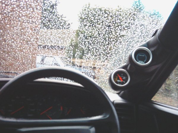

I been busy too, I have spent today installing a boost gauge, a AFM gauge and a pod to mount them in. I went for the A pillar option (universal 2 pod from Regal in Southampton as I was passing them yesterday).

I also have some nice carbon fibre sill protectors to fit and the vacuum line kit - thanks for the tip John - usefull for joining the boost gauge in - Installed the length from the dump valve and joined into the old line, removing a rubber 'T'. I used this to join in the boost gauge pipe which was slightly thin, so I wrapped a couple of turns of tape to make it snug. will tidy it later.

Tony - pics of the A pillar gauge, come on!!!!! [8|]
I think I want to go down this route if it looks okay as I really can't keep an eye on the gauge down there in the cubby. I didn't have my accurate boost gauge installed until after the Guru kit went in, so I can't say what psi I had before [:(]

Pics to follow! [:)]

Gauges both working, I used the thin wire method in the socket for the AFM pick-up there a 3 pins 2male / one female (or the opposite on the other plug) guessed this might be power, earth and sensor tested with a meter and was correct - great these German engineers.
Wired supply from the radio so that I din't have to mess with car loom and the light for boost gauge from my extra lights that illuminate the console switches - haven't driven it as I had a nice bottle of wine with dinner, but at tick over AFM starts steady and then oscillates from just in the lean section to just rich - the gauge paperwork suggests this would happen when the engine management computer is in closed loop, adjusting injector time to maintain a stoich A/F ratio.
