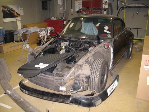

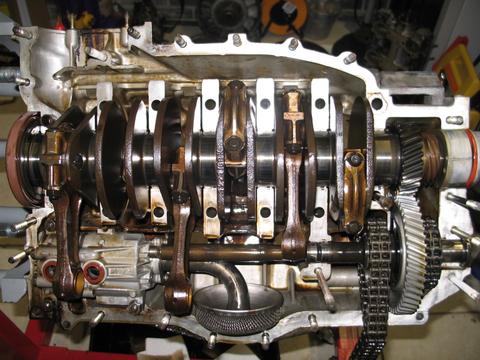

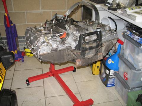

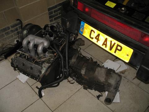

Guys,
Finally managed to grab some time and update this thread with some pics...
